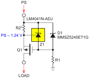

A typical three-wire [power supply (PS), ground, and load] precision positive current source offering an accuracy of 1% or better. The output current is 1.24/R2
AuthorsStephen Woodward
Main DocumentArticle «Two-wire precision current source with wide current range»
DescriptionFigure 1
File Format / SizePDF / 9 Kb
A typical three-wire [power supply (PS), ground, and load] precision positive current source offering an accuracy of 1% or better The output current is 1.24/R2
