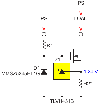

Figure 1. A typical three-wire [power supply (PS), ground, and load] precision positive current source offering an accuracy of 1% or better. The output current is 1.24/R2
Figure 2. A typical three-wire negative current source, or a current sink
