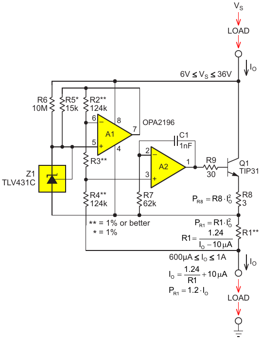

Figure 4. A two-wire source/sink with 1% or better precision over > 1000:1 output range
