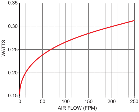

This graph shows the power dissipated vs air speed of a TO-92 held at a constant 31 °C above ambient P
W
= 31/Z
T

Figure 1. This graph shows the power dissipated vs air speed of a TO-92 held at a constant 31 °C above ambient P
W
= 31/Z
T
