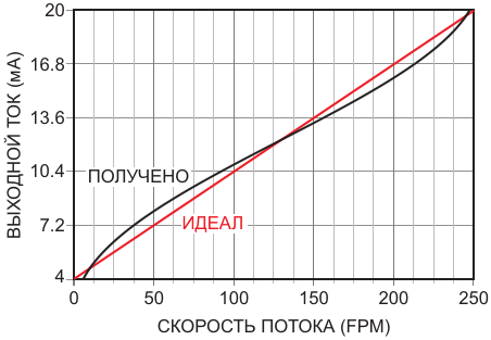

This graph's data relates …
This graph's data relates anemometer output vs airspeed: F

Figure 4. This graph's data relates anemometer output vs airspeed: F
PM
= 15.6(I
OUT
- 4 mA) ±10 fpm
