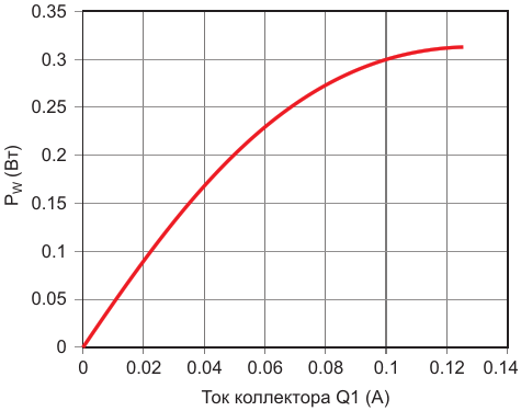

This graph details Q1 …
This graph details Q1 power dissipation vs collector current. P
W
= 5 V·I - I
2
R3

Figure 3. This graph details Q1 power dissipation vs collector current. P
W
= 5 V·I - I
2
R3
