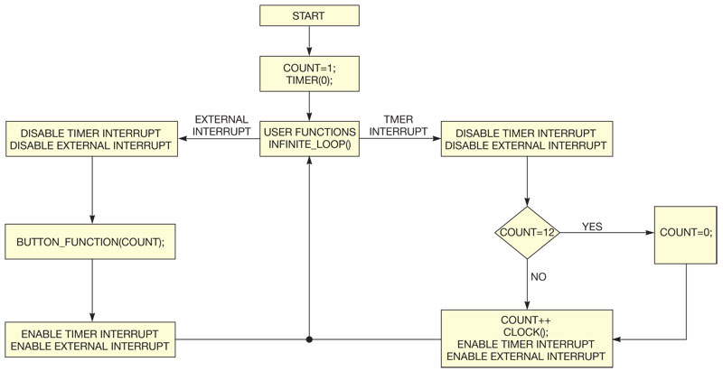

The example described here shows how to implement this method to read a 4×3 matrix keyboard. One CD4017 is used to control the keyboard rows, while the other is used to control the columns.
The MCU generates a clock signal and feeds it to the counter IC controlling the columns. Initially, the 0th output of the column counter and row counter is at logic high, and the column counter increments as it receives clock pulses. At the fourth clock pulse, the column counter resets and simultaneously increments by one the counter controlling the rows. As the column controller resets, the row controller increments and the row controller resets with the fifth clock pulse from the column controller. As clock pulses generate, a count variable on the MCU should be incremented and should reset to one upon the fifth clock pulse to the row controller. The output of the keyboard is OR’ed and connected to an external interrupt pin of the MCU.
An interrupt occurs only if a button pressed when both the row and the column of the respective button are at the logic-high level. If either row or column of the button is logic zero, an interrupt will not occur.
When an interrupt occurs, the MCU reads the count value at the moment; that value is equal to the button just pressed.
The clock count kept in the MCU increments as it generates clock pulses in intervals; this count is equal to the switch number on the keypad that could generate an interrupt if pressed. The flow chart in Figure 2 illustrates this scenario.

Figure 2. The clock count kept in the MCU increments as it generates clock pulses in intervals; this count is equal to the switch number focused at the moment.
