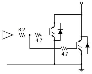

Combined Common and Separate Gate Resistors
