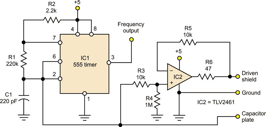

Figure 1. In this large-area capacitive sensor, C1 and any parallel capacitance set the frequency of the 555 astable multivibrator IC1, while IC2 buffers the voltage at the capacitor to drive the shield plate. (The pin-outs for IC1 are for the “N” package.)
The circuit in Figure 1 performs the main capacitance-sensing task, while leaving detection to a microcontroller. IC1 is a 555 timer wired as an astable multivibrator with as small a timing capacitance as possible. With the component values shown, the frequency is slightly above 10 kHz. IC2 buffers the voltage on this capacitor to drive a shield plate.
For IC2, resistors R3 and R4 decrease the buffered voltage by about 1%. This prevents oscillation that may occur because of the external capacitance. R6 is included since some operational amplifiers have difficulty driving a capacitive load. IC2 should have a high gain-bandwidth product to allow a faithful representation of the signal voltage without phase shift.

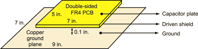

Figure 2. In the constructed sensor, a double-sided printed-circuit board (PCB) has one conductor as the signal plate and the other as the driven shield. The semi-infinite ground plane, which is slightly larger in area than the sensing or shield plates, can be another PCB or an aluminum plate.
Figure 2 shows the construction of the sensing plate. These are the dimensions used in the author’s tests, but quite a lot of variation is permissible. A practical implementation would be to build the circuitry onto an edge of the ground plane.

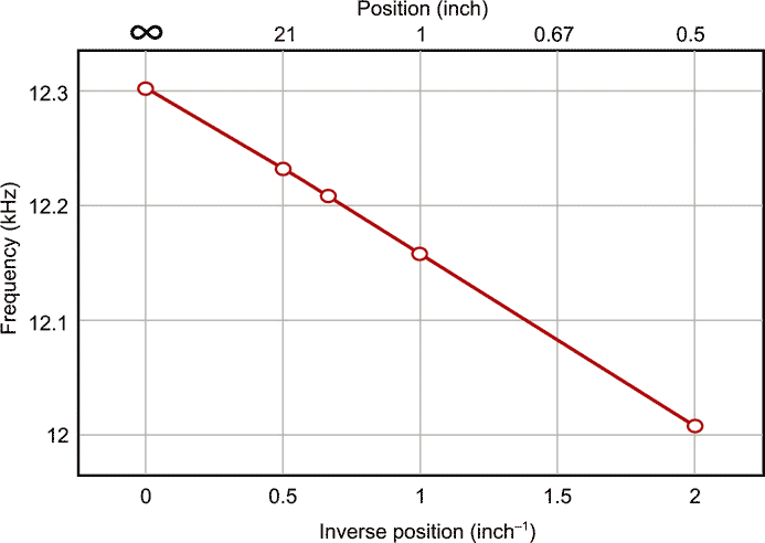

Figure 3. The circuit response is a close-to-linear inverse-position relationship between hand position and the sensing plate.
The frequency response decreases in a nearly linear fashion with respect to inverse position (Fig. 3). In the author’s test, hand contact reduced the frequency to 10.47 kHz. Hand contact through a 0.375-in. (10 mm) thick piece of plywood or gypsum wallboard resulted in a frequency change of 10%, which is easy to detect. Although frequency-detection ICs are available, a simpler, less expensive solution is to use a microcontroller to detect a change in signal period.
