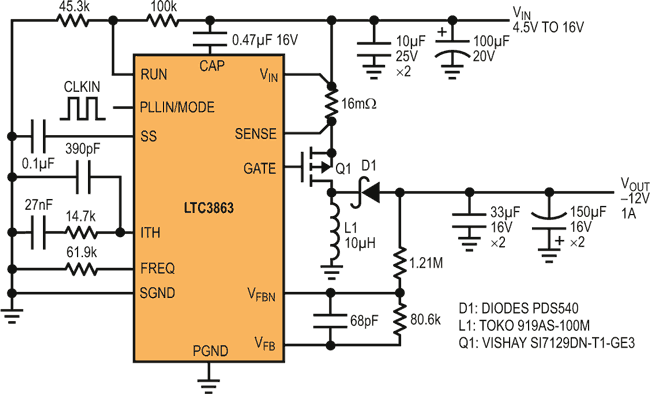

–12 V, 1 A Converter Operates from a 4.5 V to 16 V Source
The circuit shown in Figure 1 produces a –12 V, 1 A output from a 4.5 V–16 V input. Operation is similar to a flyback converter, storing energy in the inductor when the switch is on and releasing it through the diode to the output when the switch is off, except that with the LTC3863, no transformer is required. To prevent excessive current that can result from minimum on-time when the output is short-circuited, the controller folds back the switching frequency when the output is less than half of nominal.

Figure 1. Inverting converter produces –12 V at 1 A from a 4.5 V–16 V source.
The LTC3863 can be programmed to enter either high efficiency Burst Mode operation or pulse-skipping at light loads. In Burst Mode operation, the controller directs fewer, higher current pulses and then enters a low current quiescent state for a period of time depending on load. In pulse-skipping mode, the LTC3863 skips pulses at light loads. In this mode, the modulation comparator may remain tripped for several cycles and force the external MOSFET to stay off, thereby skipping pulses. This mode offers the benefits of smaller output ripple, lower audible noise and reduced RF interference, at the expense of lower efficiency compared to Burst Mode operation. This circuit fits in about 0.5 in2 (3.2 cm2) with components on both sides of the board.

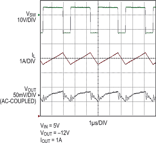

Figure 2. Switch node voltage, inductor current and ripple waveforms
at 5 V input and –12 V output at 1 A.

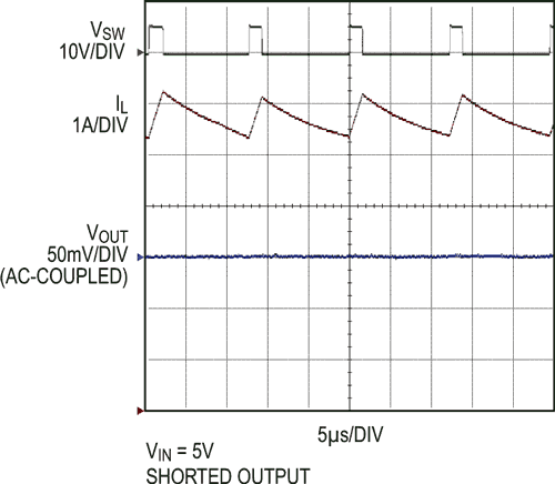

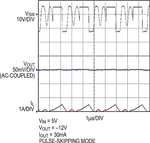

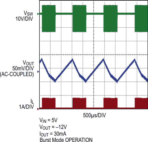

Figure 2 shows the switch node voltage, inductor current and ripple waveforms at 5 V input and –12 V output at 1 A. The inductor is charged (current rises) when the PMOSFET is on, and discharges through the diode to the output when the PMOS turns off. Figure 3 shows the same waveforms at 70 mA out in pulse-skipping mode. Notice how the switch node rings out around 0 V when the inductor current reaches zero. The effective period stops when the current reaches zero. Figure 4 shows the same load condition with Burst Mode operation enabled. Power dissipation drops by 36% at this operating point, and efficiency increases from 72% to 80%. Figure 5 shows waveforms with the output shorted. The switching frequency is reduced to about 80 kHz in this condition to prevent excessive current that could otherwise result.

Figure 3. Switch node voltage, inductor current and ripple waveforms at
5 V input and –12 V output at 30 mA in pulse-skipping mode.

Figure 4. Switch node voltage, inductor current and ripple waveforms at
5Vinput and –12 V output at 30 mA in Burst Mode operation.

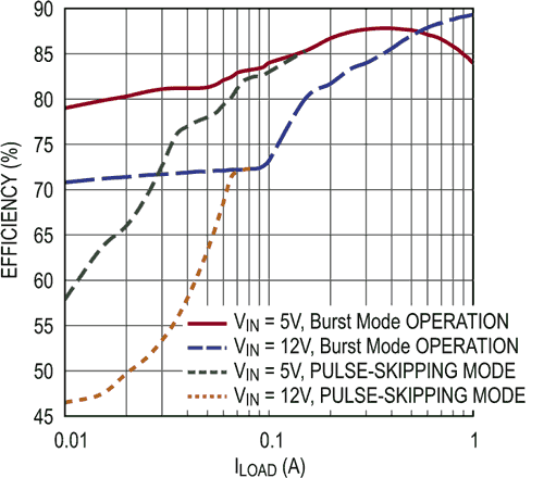

Figure 6. Efficiency in normal and Burst Mode operation.
Figure 6 shows efficiency curves for both pulse-skipping and Burst Mode operation. Exceptional efficiency of 89.3% is achieved at 1 A load and 12 V input. Note how Burst Mode operation dramatically improves efficiency at loads less than 0.1 A. Pulse-skipping efficiency at light loads is still much higher than that obtained from continuous conduction.
