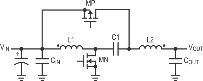

Figure 1 shows the basic connections and elements of the four-quadrant converter. NFET, MN and PFET, MP are operated out of phase from one another and at a constant switching frequency. Current mode control is used (not shown) to modulate the duty cycle of MN as needed.

If we assume fixed frequency operation, the duty cycle for the ON time of MN can be calculated as
From this equation, it is clear that with a positive VIN voltage, the output voltage VOUT can be positive (up to VIN) or negative (limited only by practical DC considerations) and can go to 0 V as well. In fact, there is nothing special about the 0 V output level since the DC of the converter is 50% at that operating point.
The output of this converter can sink or source current regardless of the polarity of the output voltage, making this a true four-quadrant operating topology. The maximum drain to source voltage stress on MN and MP are both 2VIN – VOUT. For example, if VIN is +12 V and VOUT is –12 V, then the BVDSS ratings for both FETs must be greater then 36 V.

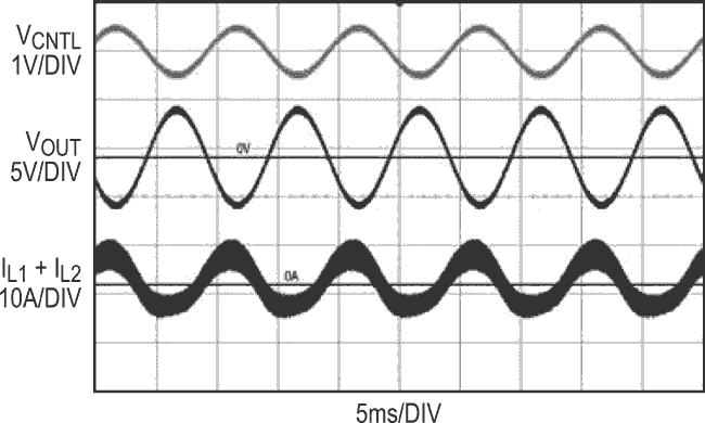

The four-quadrant operating capability of the converter is shown in Figure 3. Here, a sinusoidal control signal is used to generate a sinusoidal output voltage centred on 0 V. The inductor currents can go positive or negative; whatever is necessary to have the output voltage go to the commanded level. The operating waveforms show clean and smooth operation through the ground potential. The choice of using a sine wave control signal is arbitrary; a DC signal, square wave signal or any other type of signal could also be used.

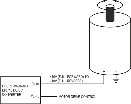

Another application that can benefit from the four-quadrant topology is DC motor drives. In many cases, DC motors need speed adjustment as well as reverse capability. The LT8710 used in the four-quadrant converter can do both. Figure 5 shows such an application. Note that the negative terminal of the DC motor can be simply tied to ground while the positive terminal can be adjusted between positive and negative 10 V. Similar to the DC motor drive application, the four-quadrant topology can also be used to drive thermoelectric coolers (TECs), audio speakers, and many other applications.
