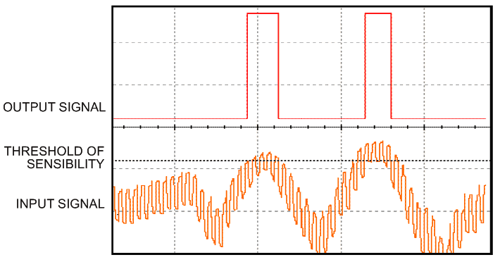

Figure 2. The circuit recognizes a pulse when it falls;
noise is exaggerated for clarity.
A rising input signal greater than the threshold charges C2 to approximately the level of the input signal. The output amplifier is at a high level because the voltage on C2 is always lower than the value of the rising input signal due to D1’s voltage drop. When the input drops faster than C2 can discharge through R5, the output level of the device changes to a low level because the voltage on C2 is higher than the value of the falling input signal. If the input signal falls more slowly than the discharge of C2 through resistor R5, the output remains high. Schottky diode D1 prevents the discharge of C2 through the input. R2 and D2 clamp the amplifier’s output to positive values. Feed the clamped signal to Schmitt-trigger logic gate IC2 to give a logic-level output with fast transitions (Figure 2).
