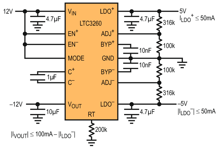

Dual-polarity supplies are commonly needed to operate electronics such as op amps, drivers, or sensors, but there is rarely a dual-polarity supply available at the point of load. The LTC3260 is an inverting charge pump (inductorless) DC/DC converter with dual low noise LDO regulators that can produce positive and negative supplies from a single wide input (4.5 V to 32 V) power source. It can switch between high efficiency Burst Mode® operation and low noise constant frequency mode, making it attractive for both portable and noise-sensitive applications. The LTC3260 is available in a low profile 3 mm × 4 mm DFN or a thermally enhanced 16-lead MSOP, yielding compact solutions with minimal external components. Figure 1 shows a typical 12 V to ±5 V application featuring the LTC3260.
High Voltage Inverting Charge Pump Produces Low Noise
Figure 1. Typical 12 V to ±5 V Supply.

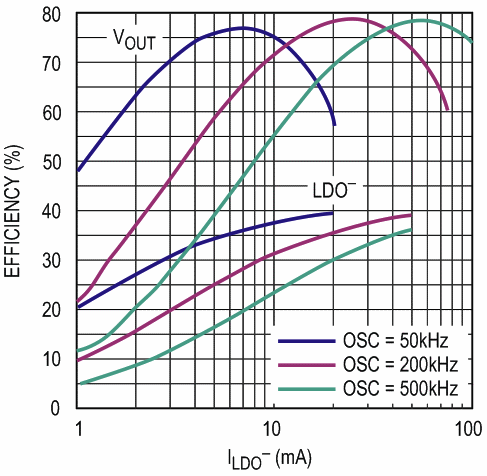

Figure 2. LTC3260 VIN to VOUT and VIN to LDO Efficiency vs
Frequency for the Circuit in Figure 1.
Light load efficiency can be increased by reducing the operating frequency, as shown in Figure 2, but at the expense of increased output ripple. The lower operating frequency produces a higher effective open-loop resistance (ROL), but the reduced switching rate also reduces the input current, resulting in increased efficiency at light loads. Furthermore, at relatively heavy loads, the increased ROL reduces the effective difference between VOUT and LDO – decreasing the power dissipation in the negative LDO. The cumulative result is higher overall efficiency with high input voltages and/or light loads.

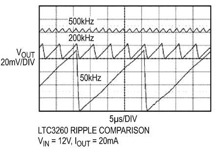

Figure 3. VOUT Constant Frequency Ripple Comparison at 500 kHz,
200 kHz and 50 kHz at 20 mA Load.
Reducing the frequency increases the output ripple as shown by the expression below and in Figure 3.

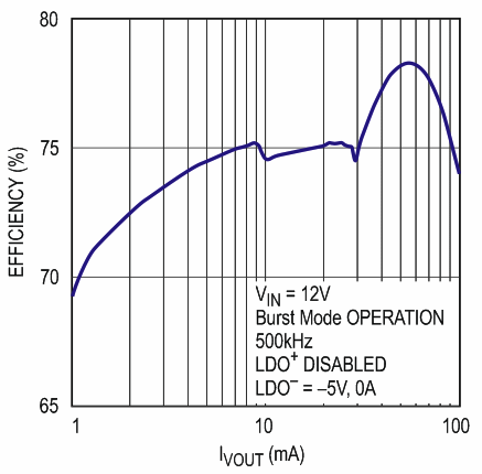

Figure 4. LTC3260 Burst Mode Operation Efficiency.
Figure 4 shows the light-load efficiency of the charge pump in Burst Mode operation. Burst Mode operation increases the output ripple over constant frequency mode, but the increase in ripple is only a small percentage of VIN, as shown in Figure 5.

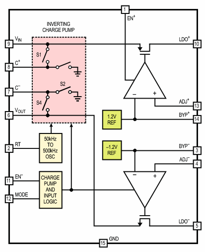

Figure 5. VOUT Ripple in Burst Mode Operation.
Burst Mode operation is implemented by charging VOUT close to –VIN. The LTC3260 then enters a low quiescent current sleep state, about 100 μA with both LDO regulators enabled, until the burst hysteresis is reached. Then the charge pump wakes up and the cycle repeats. The average VOUT is approximately –0.94VIN. As the load increases, the charge pump runs more often to keep the output in regulation. If the load increases enough, the charge pump automatically switches to constant frequency mode in order to maintain regulation.
