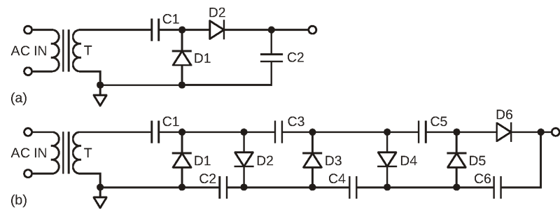

The key to this circuit is using a number of switches and capacitors to boost a lower voltage to a higher one. The first circuits were used to convert a high voltage AC voltage to an even higher DC voltage (Figure 1). Most applications for capacitive voltage converters are now for DC to DC. By using cascaded diode/capacitor stages, very high voltages could be generated while still using diodes and capacitors with voltage ratings of the individual stages, since the components only see the voltage in its own stage. The basic circuit is shown in Figure 2a. In this circuit the capacitor C2 top plate is charged to Vp on the positive half cycles and the bottom plate of C2 is charged to –Vp on the negative halve cycles. This means the voltage on C2 equals 2Vp. Multiple stages are connected in series, therefore each increase the voltage by 2Vp. In Figure 2b, the output will be 6× the peak voltage at AC in. C1, C3, and C5 pass the AC voltage along and C2, C4, and C6 are stacked to store the charge relative to the ground of the stages. A full wave version of this can also be implemented, as in Fig. 1, so the voltage becomes twice the voltage of the half wave example shown.
Single and multi-stage Greinacher multipliers.
Figure 2. Single and multi-stage Greinacher multipliers.

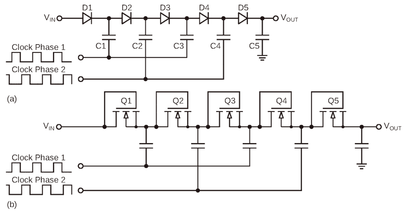

By slightly rearranging the diodes and capacitors, it is possible to comprise a circuit known as the Dickson charge pump. The Dickson charge pump (Figure 3) was patented by John F. Dickson in the late 1970s. It is used primarily in EEPROM/flash memory ICs to generate the programming/rewrite voltages that are well beyond the voltage that is available otherwise.
Dickson charge pumps use diodes and MOS-connected diodes.
Figure 3. Dickson charge pumps use diodes and MOS-connected diodes.
The Dickson charge pump in Fig. 3a is very similar to the Greinacher doubler. A DC voltage is applied at VIN to diode D1’s anode. The voltage at the cathode of D1 will be one diode drop below VIN, and the anode of D2 will be another diode drop below that. When a VIN-level clock is applied to capacitor C1, the top of C1 will rise to the combined voltage of the output of D1 and the clock high level. This voltage then charges the second capacitor C2, already one diode below D1, through diode D2. The second capacitor now has the VIN voltage times two, minus the 2-diode voltage drops.
The multi-stage Dicksons in Fig. 3 uses a two-phase VIN-level clock that drive alternating capacitors, but a single stage could be used if a large output voltage boost is not required. Each stage is the clock level minus a diode drop higher than the previous stage, or

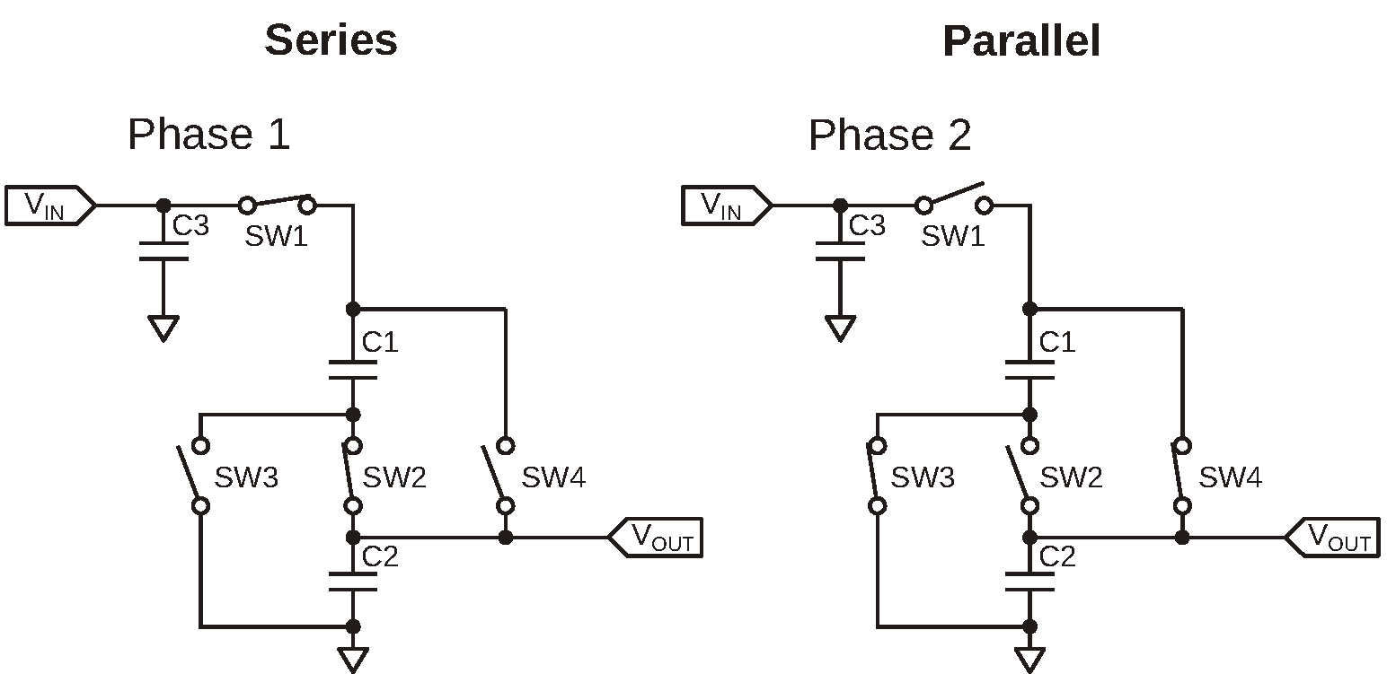

The next type of charge pump could be called the “trapeze” charge pump, but is better known as the flying capacitor charge pump. These are very versatile because they can be used to boost, reduce, or change the polarity of the voltage it is providing. What makes them unique in their operation is that both ends of the capacitor are momentarily disconnected from the other circuitry at the same time, hence flying. Again, switches, almost always MOS transistors, are used to direct the current flow, but are used in pairs to connect the top and bottom of the capacitor to the charging source or the destination. It is important that there is dead time between states when switching the source and load switches so they are not closed at the same time. That could be a bad thing and cause current to flow where it is not wanted, therefore the need to “fly” between domains.
Figure 5 shows one example of a flying capacitor charge pump. The ports referenced VIN and VOUT have those functions in a voltage reduction mode of operation. The voltage at VIN is the voltage source and VOUT is the voltage being generated. In phase 1, the capacitors C1 and C2 are connected in series with switches SW1 and SW2, so each capacitor will be one half the voltage at VIN. In phase 2, the series switches are opened up and the parallel switches SW3 and SW4 are closed placing C1 and C2 in parallel and therefore have ½VIN as their combined voltage charge, so they have half the voltage, but twice the charge current available on the output due to the parallel capacitors.

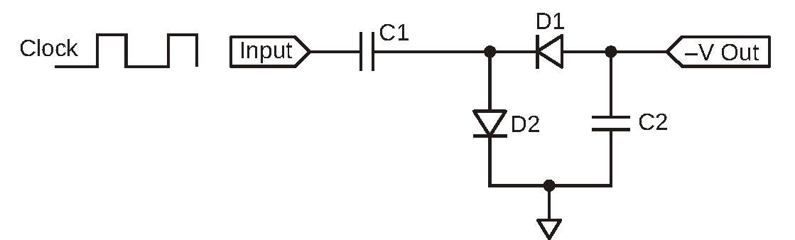

Another charge pump topology can also be used to generate a negative voltage from a positive one. This uses a diode-switched capacitor. All that is needed is a clock with an amplitude equal to the negative voltage that is desired.
In Figure 6, the input clock supplies the needed signal. On the positive edges the clock passes through C1 and D2 to ground. When the clock transitions to the low state, the AC coupled clock turns on D1 and charges C2 with a negative voltage. After a few cycles C2 is charged to the negative voltage equal to the clock’s amplitude, minus a diode drop. The amount of current available primarily depends on the impedance of the source, the frequency, and the size of the holding capacitor.
