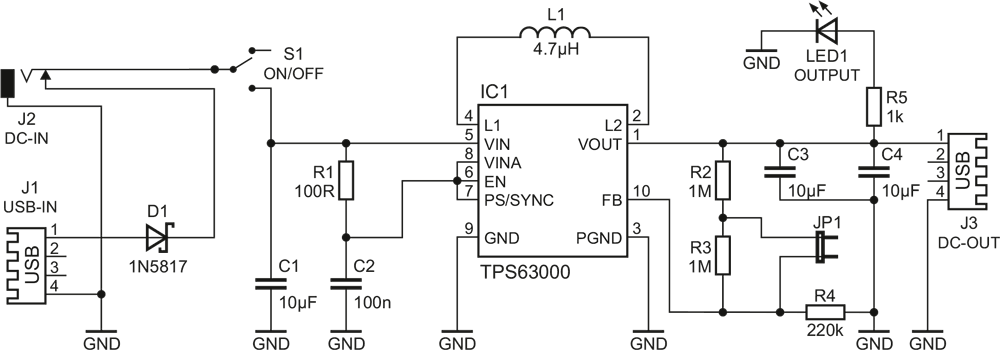

A good, reliable and easy to use dc power supply is probably the most important thing for every electronics hobbyists. Since a proper electronically stabilized power supply is crucial for almost all microcontroller-related diy projects, here we are presenting a simple diy project of an easy to build and very affordable power supply for microcontrollers.
Circuit Description
The design is centered around TPS63000 (IC1) from Texas Instruments, the high-efficient single inductor buck-boost converter from Texas Instruments (Figure 1). Here the power supply offers a regulated 3.3 V/5.0 V output, processed from an input voltage range of 1.8 V to 5.5 V, with up to 96% efficiency. We can use either a usb port power (through J1), a two-cell or three-cell alkaline, NiCd or NiMH battery, or a Li-ion/Li-polymer battery (through J2) as the input of this power supply.
Smart Power Supply for Microcontroller Projects
Figure 1. Smart Power Supply for Microcontroller Projects.
Note that the buck-boost conversion of TPS63000 is based on a fixed frequency, pulse width modulation controller using synchronous rectification to obtain maximum efficiency.
TPS63000 Features:
  • Input Voltage Range: 1.8 V to 5.5 V
  • Fixed and Adjustable Output Voltage Options from 1.2 V to 5.5 V
  • Up to 96% Efficiency
    • 1200-mA Output Current at 3.3 V in Step-Down Mode (VIN = 3.6 V to 5.5 V)
    • Up to 800-mA Output Current at 3.3 V in Boost Mode (VIN > 2.4 V)
  • Automatic Transition Between Step-Down and Boost Mode
  • Device Quiescent Current less than 50 μA
  • Power-Save Mode for Improved Efficiency at Low Output Power
  • Forced Fixed Frequency Operation and Synchronization Possible
  • Load Disconnect During Shutdown
  • Overtemperature Protection
  • Available in a Small 3 mm × 3 mm 10-Pin VSON Package (QFN)
Within the TPS6300x family, there are fixed and adjustable output voltage versions available. Here we used its adjustable ouput version, and connected a resistor divider (R2-R4) between VOUT, FB and GND of TPS63000. If the jumper (JP1) is in open condition, the final output voltage (available at J3) is 5 V, and if the jumper is closed, the same output voltage is locked to 3.3 V.

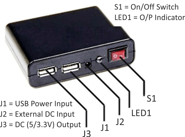

Figure 3. Case option for Smart Power Supply.
