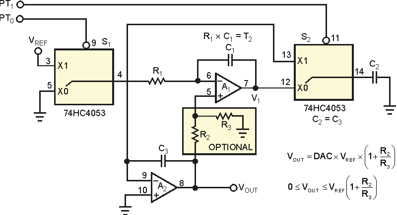

| Figure 1. | This DAC ripple filter combines a differential integrator, A1, with a sample-and-hold amplifier, A2, in a feedback loop operating synchronously with the PWM. |
The circuit in Figure 1 avoids most of the problems of lowpass filtering by combining a differential integrator, A1, with a sample-and-hold amplifier, A2, in a feedback loop operating synchronously with the PWM cycle, T2 in Figure 2. If you make the integrator time constant equal to the PWM cycle time – that is, R1 × C1 = T2 – and, if the sample capacitor, C2, is equal to the hold capacitor, C3, then the filter can acquire and settle to a new DAC value in exactly one PWM-cycle time. Although this approach hardly makes the resulting DAC exactly “high speed,” 0.01-sec settling is still 100 times better than 1-second settling. Just as important as speed, this improvement in settling time comes without compromising ripple attenuation. Ripple suppression of the synchronous filter is, in theory, infinite, and the only limit in practice is nonzero-charge injection from S2 into C3. The choice of a low-injected-charge switch for S2 and an approximately 1-µF capacitance for C3 can easily result in ripple amplitudes of microvolts.
| Figure 2. | The DAC output settles within one cycle. |
Optional feedback-voltage divider R2/R3 provides flexibility in a DAC-output span with common voltage references. For example, if R2=R3, then a 0 to 10 V output span will result from a 5 V reference. An additional advantage of this method of span adjustment is that output ripple remains independent of reference amplification.
