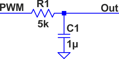

Figure 2. Comparison/simulation circuit.

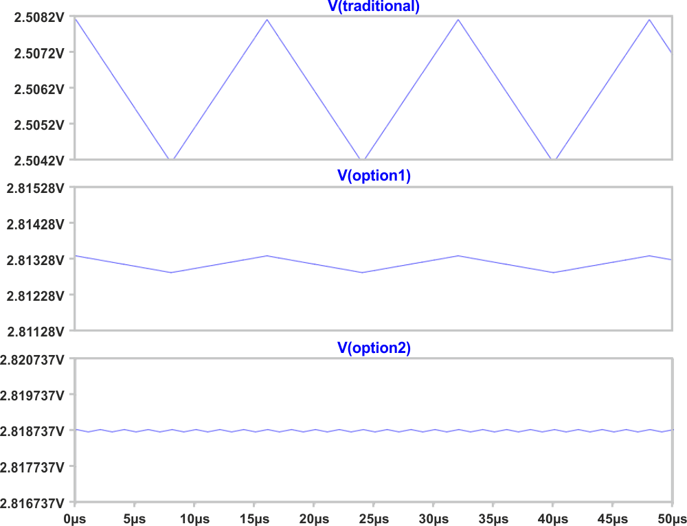

To compare with the traditional simple low-pass filter (Figure 2) you should remember that the output resistance of an R-2R ladder is R, and since I propose paralleling two resistors from the array to form R (with individual resistors for 2R), a 10 kΩ array yields 5 kΩ output resistance. That is what I used for the traditional approach along with the same 1 µF capacitor. I set the PWM to 50% duty cycle as that is where the worst ripple occurs. The results of the simulation (Figure 3) show the traditional approach with about 4 mV of ripple, while the first option (adding the three new bits to the original eight) resulted in 493 µV of ripple, just about one eighth. The second option (increasing the PWM clock by eight, leaving eight bits total) generated only 61 µV, around one sixty-fifth of the original.

Figure 3. Simulation results.

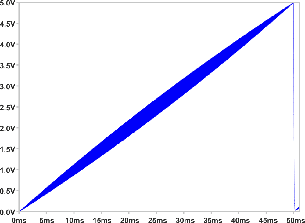

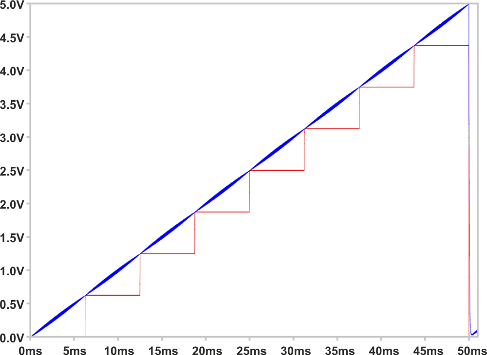

Figures 4a (PWM + low-pass) and 4b (11-bit hybrid) are the results of a complex simulation which slowly steps the voltage from 0 V to 5 V. The capacitors in the filters are deliberately too small so we can see the ripple at this scale. A normal R-2R ladder adds a stair-step graph (Red in 4b) to show how the PWM moves from one level to the next, and even beyond the top of the R-2R ladder up to 5 V.

Figure 4. Simulated ripple of basic PWM DAC (fig4a, top),
and hybrid DAC (fig4b, bottom).
