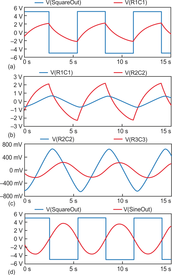

By increasing the values of the network components, this circuit can generate sinusoids with periods of the order of a minute or more, which largely depends on the characteristics of the components. With the high resistor values shown, the op amps must be CMOS devices in order to have the necessary extremely high input impedance, and the timing capacitors must also have very low leakage. Figure 2 shows the circuit’s waveforms at critical points.
| Figure 2. | The waveforms at four critical points include the output of U1 (the square wave) and the junction of R1 and C1 (the “triangular” wave) (a); the waveforms at R1/C1 and R2/C2 (b); the waveform at R2/C2 and the sinusoidal waveform at R3/C3 (c); and the square-wave and sine-wave outputs from this simple generator (d). |
