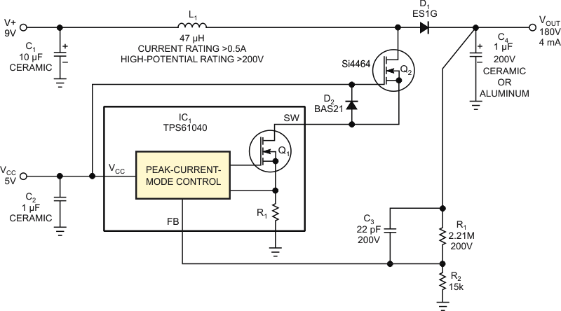

You can add a higher voltage MOSFET transistor, Q2 (Figure 2), for applications that require an output voltage higher than the internal transistor's breakdown voltage. To maintain the circuit's current-flow path through L1 and IC1's SW pin, you connect the external transistor in a cascode, or common-gate, configuration.
Cascode MOSFET increases boost regulator's input- and output-voltage ranges
Figure 2. Adding an external cascode-connected MOSFET transistor, Q2, with higher breakdown-voltage ratings,
enables the circuit to produce higher output voltages.
Q2 comprises a low-on-resistance, low-gate-voltage-threshold MOSFET with the addition of diode D2 between Q2's gate and source. To ensure the circuit's proper operation, VCC – 5 V in this example – must exceed Q2's gate-threshold turn-on voltage. In operation, IC1's internal control circuit turns on Q1, which pulls Q2's source close to ground level and turns on Q2 with almost 5 V of gate-to-source potential.
Current flows through inductor L1, external transistor Q2, internal transistor Q1, and sense resistor R1, and IC1's control circuit "sees" no difference with the installation of Q2. Once the inductor current reaches its preset limit, Q1 turns off, leaving Q2 with no path for current to flow from its source. The voltage on Q2's drain rises rapidly to the desired output voltage plus the voltage drop across D1. As the drain voltage rises, Q2's drain-to-source capacitance attempts to pull the MOSFET's floating source above 5 V, which forward-biases D2, connects IC1's SW pin voltage to 5 V plus one diode drop, and clamps Q2's source to the same voltage.
A boost converter delivers a 180 V output at 4 mA (VOUT) to bias a laser circuit from a 9 V power supply (V+). In this application, the 5 V input supply need provide only enough current – typically, a few milliamperes – to drive IC1's internal logic and the gate of cascode MOSFET Q2. You can use a dropping resistor and zener-diode voltage regulator (not shown) to supply the 5 V requirement from the 9 V supply. You can drive the inductor and IC1 from a common power supply or from a separate source that's within Q2's breakdown-voltage rating. The cascode circuit also can produce any output voltage that's within Q2's drain-to-source breakdown-voltage rating. Specify other components with an appropriate voltage rating – for example, breakdown-voltage ratings of inductor L1 and capacitor C1 should safely exceed the desired output voltage.
