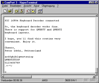

To visualize the ASCII data sent by this microcontroller application, use a terminal program like the Windows Hyperterminal. Below an example session, which proves the correct functionality of the keyboard interface. This terminal program and the Excel 97 RS232 Debug Interface have been used to debug the interface during implementation time.
Example of a session using the Windows HyperTerminal. The entire contents was sent by the PIC controller
Example of a session using the Windows HyperTerminal. The entire contents was sent by the PIC controller.

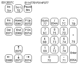

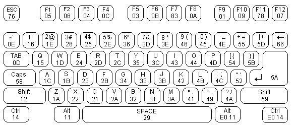

Keyboard Scan Codes
The diagram below shows the scan codes assigned to the individual keys for the english keyboard layout. The keys' corresponding scan codes are the numbers on the keys, for example the scan code of the ESC key is 0x76. All scan codes are shown in hexadecimal representation.
Keyboard Scan Codes
The scan code assignments are quite random (thanks to IBM and other early computer manufacturers) and appear to be really weird sometimes, for instance the break key. In many cases the easiest way to convert the scan code to ASCII characters would be to use a lookup table. Below are the scan codes shown for the extended part of the keyboard and the numeric keypad.
Cite of Craig Peacock: "How about E1,14,77,E1,F0,14,F0,77! Now that can't be a valid scan code? Wrong again. It happens to be sent when you press the pause/break key. Don't ask me why they have to make it so long! Maybe they were having a bad day or something?"
By the way, AT stands for Advanced Technology...
The AT keyboard sends different scan codes on pressing, holding and releasing of each button. An example is given at the table below:
Press & Hold Down Scan Code Release Scan Code
Normal Scan Code 73 F0 73
Extended Scan Code E0 4A E0 F0 4A
All scan patterns can easily be visualized and verified with the AT Scan Code Debug Routine and the RS232 Debug Interface.

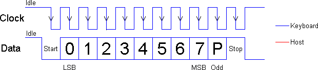

The data transfer is implemented as bi-directional protocol: The keyboard can send data to the host (microcontroller) and the host can send commands and data to the keyboard. The host has the ultimate priority over the direction. It can at anytime (although not recommended) send a command to the keyboard.
The keyboard is free to send data to the host when both KBD data and KBD clock lines are high (idle). The serial clock is generated by the keyboard, but the host can also use it as a clear-to-send line: If the host takes the KBD clock line low, the keyboard will buffer any data until the KBD clock is released, i.e. goes high. Should the host take also the KBD data line low, then the keyboard will prepare to accept a command from the host.
The transmission of data in the forward direction, i.e. keyboard to host, is done with a frame of 11 bits. The first bit is a start bit (logic 0) followed by 8 data bits (LSB first), one parity bit (odd parity) and a stop bit (logic 1). Each bit has to be read on the falling edge of the clock.
AT keyboard to host protocol, with odd parity bit

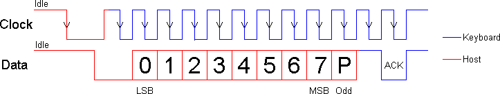

Host to Keyboard Protocol
The host to keyboard protocol is initiated by taking the KBD data line low. However to prevent the keyboard from sending data at the same time that you attempt to send the keyboard data, it is common to take the KBD clock line low for more than 60 us. This is more than one bit length. Then the KBD data line is taken low, while the KBD clock line is released. The keyboard will start generating a clock signal on its KBD clock line. This process can take up to 10 ms. After the first falling edge has been detected, you can load the first data bit on the KBD data line. This bit will be read into the keyboard on the next falling edge, after which you can place the next bit of data. This process is repeated for all 8 data bits. After the data bits comes an odd parity bit.
Host to AT keyboard protocol, with odd parity bit and acknowledge
Odd parity = NOT(XOR(bits[0..7]))
Once the parity bit has been sent and the KBD data line is in a idle state (high) for the next clock cycle, the keyboard will acknowledge the reception of the new data. The keyboard does this by taking the KBD data line low for the next clock transition. If the KBD data line is not idle after the 10th bit (start, 8 data bits, and parity bit), the keyboard will continue to send a KBD clock signal until the KBD data line becomes idle (Note: see also Limitations).

It is essentially a LUT which performs the decoding of the acquired keyboard scan codes into characters. At the top, the entries for the F1-F12 function keys are located.
If you want a specific text to be displayed by pressing F9, change the line
retlw A'9' ; F9 -> 9 0x01
