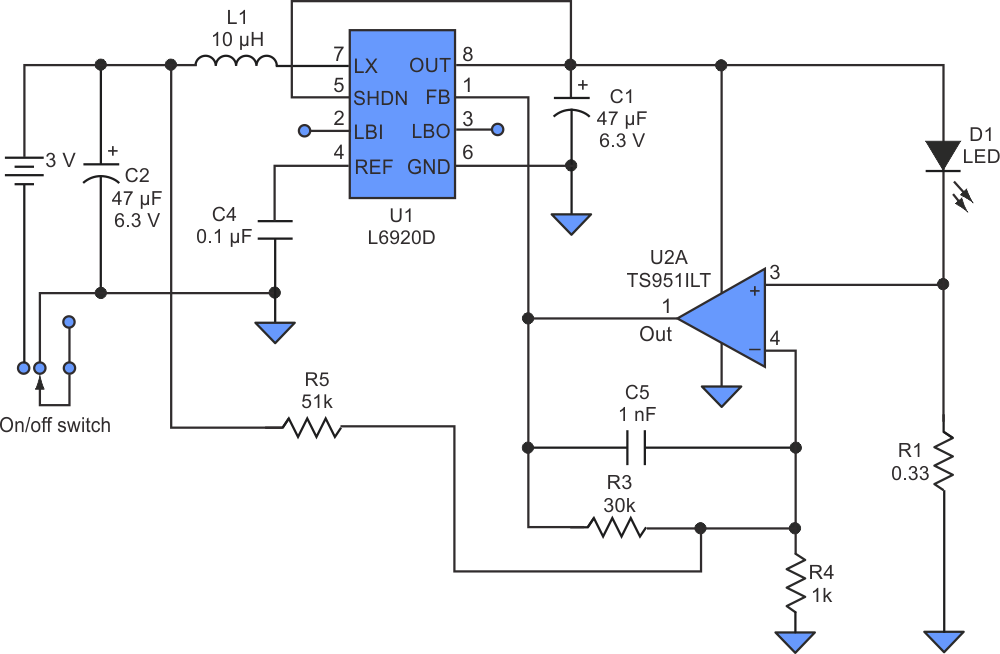

Typically, the forward voltage of a white LED is 3 to 5 V. Therefore, if the input voltage drops below 3 V, a boost converter can drive the LED. Figure 1 shows such a boost converter with automatic dimming based on battery voltage.
Using a high-efficiency step-up controller (U1), designers can create an auto-dimming function for a flashlight that employs high-brightness LEDs.
Figure 1. Using a high-efficiency step-up controller (U1), designers can create an auto-dimming
The L6920D is a high efficiency step-up controller requiring very few external components to convert the battery voltage to the selected output voltage or current. The device will start up at 1 V and operate down to 0.6 V. Its quiescent current is only 10 µA. The device also includes an internal synchronous rectifier implemented with a 120-mW P-channel MOSFET, which replaces the conventional boost diode, to improve the efficiency.
In this circuit, the LED current (ILED) is a function of the battery voltage (VFB). When the battery voltage drops, the LED current drops. In this way, the battery can last longer, and the flashlight will offer dimming characteristics. Assuming VFB = 1.23 V, determined by the L6920D:
If R5 >> R4, then R5||R4 ≈ R4, then:
Finally:

We compared a constant LED flashlight and this auto-dimming version, using two AAA batteries. Running times were 50 and 90 minutes, respectively. The auto-dimming function nearly doubled the battery life and provided a warning when the battery voltage dropped.
