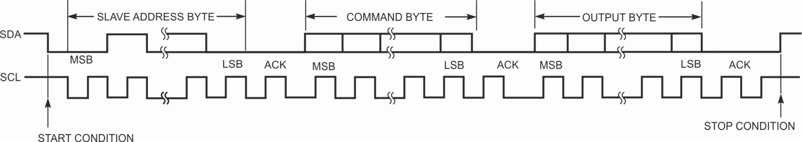

The slave side should host an I2C-compatible device, such as the MAX517 8-bit DAC or the MAX127 data-acquisition system. The master-side SDA and SCL signals are high when the bus is not in use. The I2C Start condition is typically a high-to-low transition on SDA while SCL remains low (Figure 2). With SDA low, current through R2 and the optocoupler's input causes the opto output to produce a signal of approximately 0.4 V (sum of the opto output and the forward-biased Schottky diode, D2). Pull-up resistors R1, R4, and R6 are necessary for I2C compatibility. After the master addresses the slave as described, the addressed slave responds with a low-level acknowledge bit. The bidirectional SDA line allows data transfer in both directions, but the unidirectional SCL line needs only to conduct signals from master to slave. Data transmission ends with the Stop condition, in which SDA typically makes a low-to-high transition while SCL is high.
This digram shows the I2C timing protocol for the MAX517 D/A converter.
Figure 2. This digram shows the I2C timing protocol for the MAX517 D/A converter.
