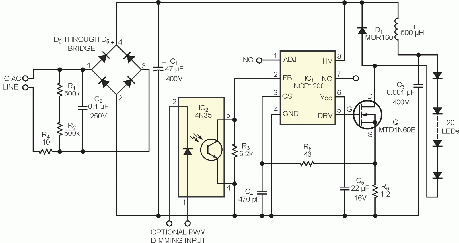

Using LEDs has gained popularity as a method of saving power for general-purpose lighting, but an efficient method for driving them has also become a necessity. For example, Lumileds' Luxeon devices create lighting effects or room lighting. Providing power to a few LEDs may require only a current-limiting resistor, but illumination applications need a string of 20 or more LEDs to provide light over an area. Based on ON Semiconductor's NCP1200A, a 100-kHz PWM current-mode controller for universal offline power supplies, the circuit in Figure 1 provides a low-cost, offline constant-current source for powering multiple LEDs. Although designers typically configure it to provide a voltage source, in this application, the NCP1200A provides a constant-current source. Figure 2 and Figure 3 show close-ups of the circuit.

A full-wave bridge rectifier, D2 to D5, and filter capacitor C1 provide approximately 160 V dc to the conversion circuit, IC1, and its associated components. Resistor R3 alters the bias for IC1's current-sense pin and, at 6.2 kΩ, allows the use of a 1.2 Ω sense resistor for R6. Decreasing R6 not only reduces costs over a higher wattage sense resistor, but also improves the circuit's efficiency. Capacitor C3 stabilizes the feedback network's current and carries a 400 V rating in case of an open circuit in the LED string. An RC network comprising R5 and C4 provides a small amount of lowpass filtering to the CS pin.

Bleeder resistors R1 and R2 eliminate any shock hazard across the ac-line plug's prongs when you disconnect it. Although you can use a 1-MΩ through-hole-mounted resistor, two surface-mounted 500-kΩ series resistors cost less and provide the required track-to-track pc-board spacing for line-voltage applications. Use a capacitor rated for line-bypass service for capacitor C2. You can use any power MOSFET with a suitable breakdown voltage and a low on-resistance, such as an MTD1N60E or IRF820, for Q1. Inductor L1, a 500-µH device, should be able to operate at 100 kHz and handle more than 350 mA of continuous current. You can use an inductor from Coilcraft's RFB1010 or DR0810 series of surface-mount inductors, or you can experiment with inductors manually wound on suitable core materials. As an option, adding optoisolator IC2 allows microcomputer-controlled illumination dimming using pulse-width modulation of IC1's feedback terminal, Pin 2.
