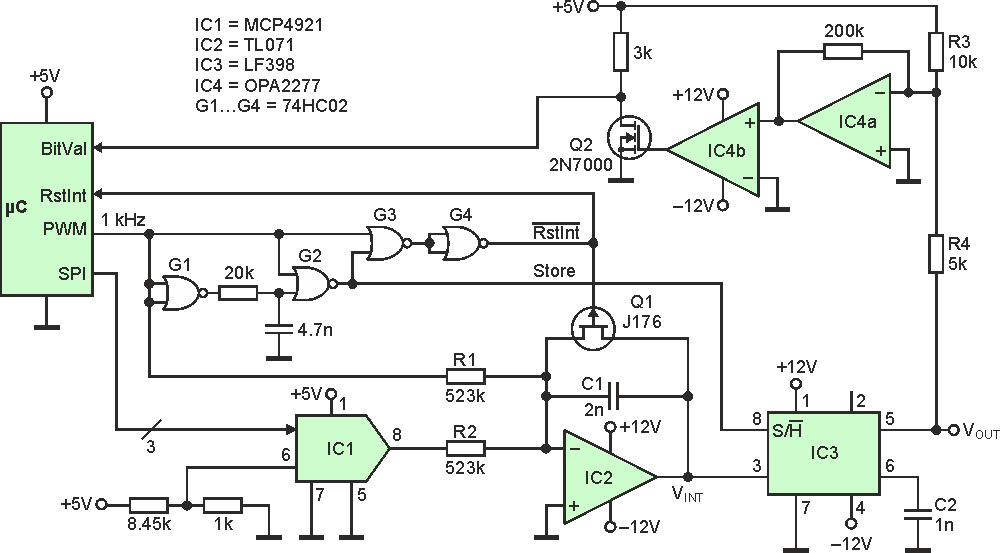

Figure 2 presents the hardware. Its operation is controlled by a timing circuit built with gates G1 through G4, which generates pulses for Q1, the reset integrator switch, and the storage switch inside the S/H unit.
As the timing diagrams in Figure 3 show, VG4 turns high at the rising edge of the PWM signal. Reset switch Q1 opens, causing the integrator to generate a negative ramp. At the falling edge of the PWM pulse, G1 and G2 generate a 10-µs trigger pulse that makes the S/H circuit capture the integrator voltage. G3 adds VPWM and VG2 pulses to keep the reset switch open until integration and storage are complete. At the end of the storage pulse, the switch turns on. Integrator resets to zero, waiting for the next PWM pulse.

Ideally, when the pulse amplitude is 5 V and the duty cycle is 50%, the output voltage should be –2.5 V. Calibration starts with configuring the PWM system inside the microcontroller (MCU) to produce a pulse train with 1 kHz frequency and 50% duty cycle. Then the MCU sends the binary number "100000000000" to the DAC and waits for the falling edge of the RstInt pulse. When the edge comes, the microcontroller reads the comparator output. R3-R4 network and IC4 compare VOUT with the ideal value of –2.5 V. If VOUT is more positive than –2.5 V, comparator output is 0, which means the first bit in the DAC number has to change to 0; otherwise that bit keeps the preset value of 1. Then the microcontroller sends out number "x10000000000" to the DAC and adjusts the value of the second bit according to comparator reaction. The third number is "xx1000000000" and the process continues until all 12 bits of the DAC number are defined.
Figure 4 demonstrates the calibration process in action. The yellow trace marks the start of the procedure; it takes place at the falling edge of the RstInt pulse. The blue trace is the output signal of IC4a. It bounces on both sides of the zero voltage and gradually gets there. The value of zero means the output voltage of the S/H circuit is half the amplitude of the width-modulated pulse. The actual ratio measured by a 4.5-digit DMM was 0.49947. Using a professionally made PCB and a high-resolution multimeter will probably achieve better match.
| Figure 4. | The successive approximation method gradually brings the output to the desired value of VP/2. |
After the calibration is complete, the MCU can adjust the duty cycle of the PWM signal according to customer settings. As the slope of the integrator ramp is properly set, the new voltage will appear at the output after only one period of the pulse train. Output voltage will be precisely equal to the DC component in the PWM signal as defined by theory and will have no ripples. The great thing is that you can calibrate your converter at any time and completely automatically.

To achieve the best adjustment accuracy, use a dedicated voltage reference instead of the +5 V power supply. Make sure the R3/R4 ratio is as close as possible to 2:1 and the offset voltages of IC2 and IC4 are as low as possible. R1 and R2 are metal film 1% resistors. C1 is a 2% capacitor with low dielectric absorption. Switch transistor Q1 should have small RON resistance. A higher resolution DAC can be used as well.
