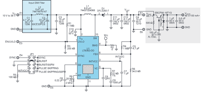

A very high performance supply can be built using the LT8362 boost converter, which features a 60 V, 2 A switch and is capable of running at frequencies up to 2 MHz, all in a package as small as 3 mm × 3 mm. The circuit presented here is based on the standard LT8362 demo board DC2628A, the schematic of which is shown in Figure 1.
| Figure 1. | Schematic demonstration circuit DC2628 used to build a phantom power supply. | |
The input EMI filter on the demo board does a good job of taking care of high frequency noise, aided by the switching inductor, which appears in series with the input. The situation is not as good on the output. The output EMI filter effectively suppresses noise in the MHz region, but has little effect on noise in the audio range. This noise mostly arises due to the 30× gain in the feedback loop amplifying the reference noise of the LT8362.
One approach to cure this noise is to add capacitance at the output. Given enough capacitance this would work, but with a 48 V output, the lowest practical capacitor working voltage of 63 V means that the required caps are both big and expensive.
A second approach would be to increase the LT8362 output a volt or two and add an LDO regulator to the output. This requires a high voltage LDO regulator, which usually costs more than the low voltage counterpart. In addition, while these regulators can have low noise at lower output voltages, devices that use a voltage reference also suffer from the same reference noise multiplication issue as the LT8362.
A third approach is to take advantage of the fact that the sensitivity of the microphone output is not highly dependent on the supply voltage, so the phantom supply does not require perfect regulation. This means we can put some resistance in series with the output caps to increase their effectiveness; however, this only partly mitigates the size of the high voltage caps.
A better approach is to make the output capacitors seem bigger than they really are. This can be accomplished with an old school technique called capacitance multiplication. This simple circuit can be seen in the gray shaded area of Figure 2.
| Figure 2. | The same circuit as Figure 1, but with a capacitance multiplier (gray) at the output to suppress audio frequency noise produced by the switching regulator. |
Here, the 100 µF cap controls the ripple on the base current, so its effect on the collector current is amplified by the beta of the NPN transistor. The effect is dramatic. Figure 3a shows the output of the LT8362 circuit at C4 (before the filter) with a 1 kΩ load (50 mA).

The transistor SBCP56-16T1G was chosen for high VCBEO (80 V) and high beta at low currents. The high beta gives the capacitance multiplier high apparent capacitance and relatively constant drop as output current varies. The output voltage drops from 47.8 V with a 2 kΩ load to 47.5 V at 500 Ω load, which is sufficient for microphone applications. Do not substitute another transistor without testing for noise and regulation.
The tests were run with 16 V input, but the performance will be similar with 12 V to 24 VIN. Some applications may require boosting from 5 V, which can be accomplished by decreasing the LT8362’s switching frequency from 2 MHz to 1 MHz to allow for the 75 ns minimum off time. This would also require increasing L1 to about 10 µH to 15 µH and doubling up on bulk output cap C4 to maintain equivalent performance.
