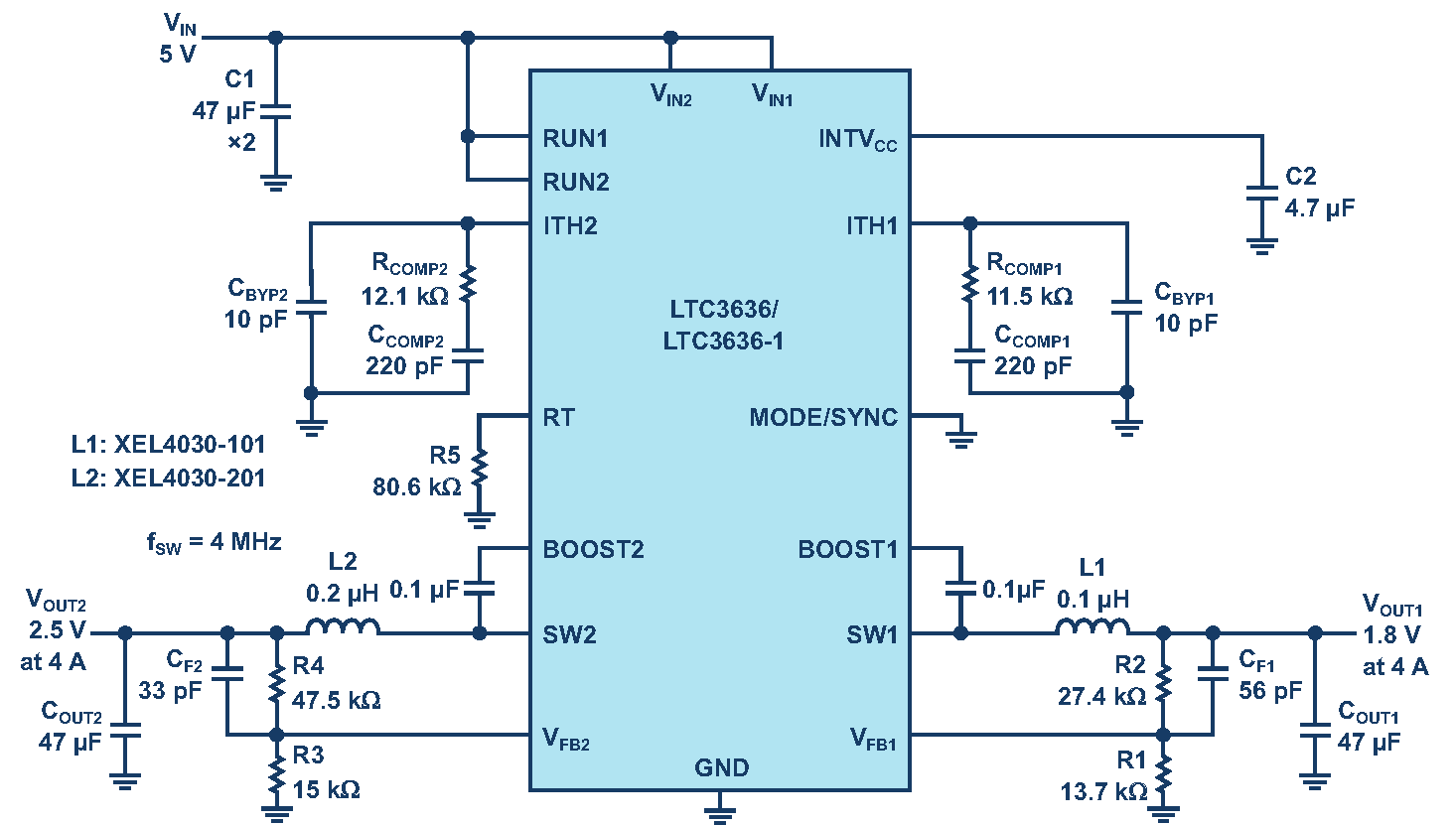

The LTC3636 is a dual-channel, 6 A per output, high efficiency monolithic step-down regulator capable of operating from input supplies up to 20 V. The programmable switching frequency can be set as high as 4 MHz. The high switching frequency significantly reduces the size and value of the inductor and capacitor, but unlike many high frequency solutions, the LTC3636 also maintains high efficiency. Some very small footprint ferrite inductors with lower ac loss and dc loss can be used. The two channels operate 180° out-of-phase, with the interleaving of the switching pulses resulting in ripple cancellation, which in turn reduces the input capacitor values.
A 4 MHz dual buck regulator delivers a compact solution.
Figure 1. A 4 MHz dual buck regulator delivers a compact solution.
The dual buck converter in Figure 1 runs at 4 MHz, with very small inductors and capacitors. Efficiency and thermal performance are shown in Figure 2. The thermal image shows a less than 40 °C temperature rise at room temperature where natural convection at VIN = 5 V.

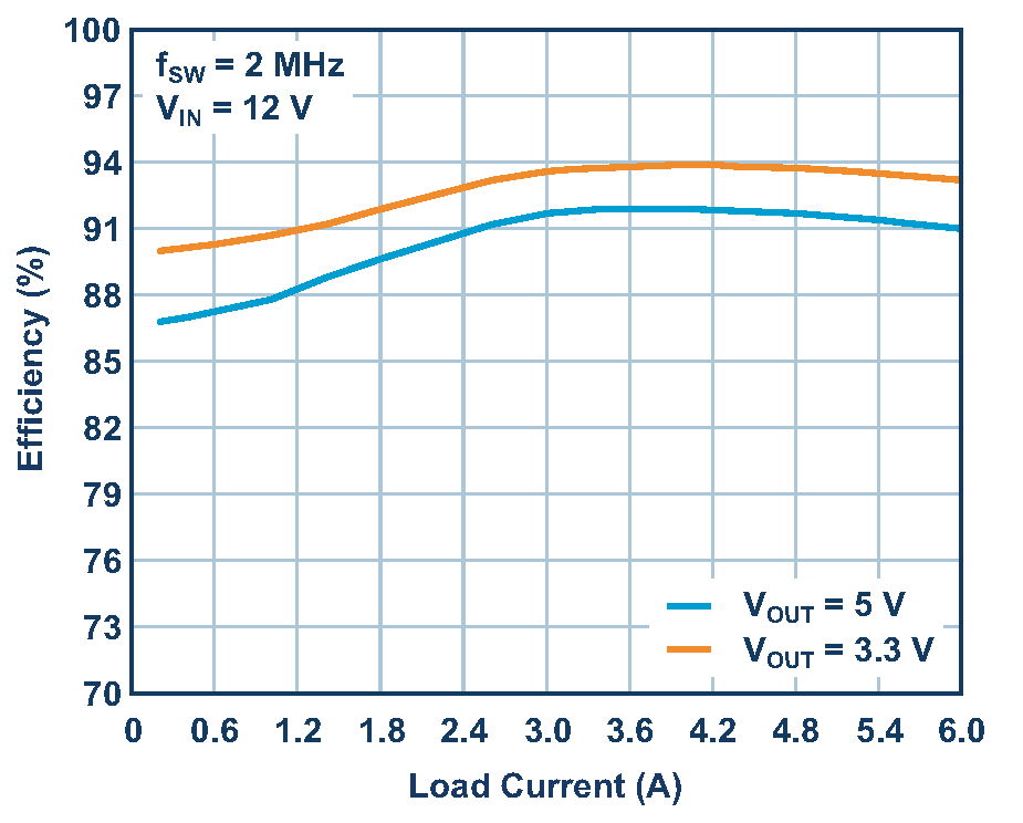

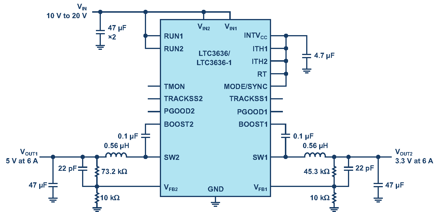

The LTC3636 regulator features low quiescent current for high efficiency for output up to 5 V. The LT3636-1 version extends the VOUT range to 12 V. The step-down regulator operates from an input voltage range of 3.1 V to 20 V while delivering up to 6 A of output current per channel. Figure 3 shows a high efficiency solution while Figure 4 shows its measured efficiency remains high throughout the operating range.
High efficiency dual buck regulator.
Figure 3. High efficiency dual buck regulator.

The efficiency curve for VOUT = 5 V and 3.3 V.
Figure 4. The efficiency curve for VOUT = 5 V and 3.3 V.

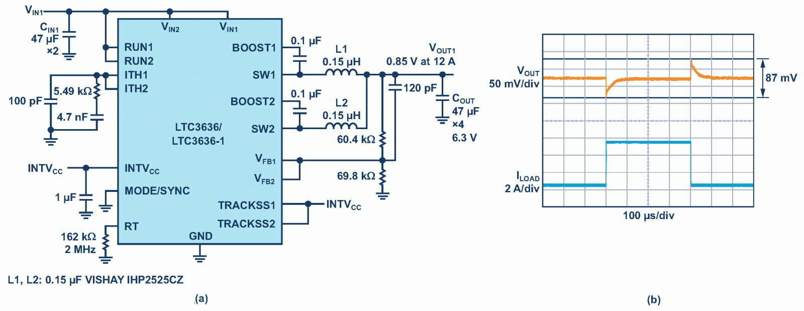

The proliferation of advanced SoC and FPGA electronic systems in automotive, transportation, and industry applications requires higher performance power supplies. Power budgets of these advanced SoCs continually rise and the solutions based on traditional PWM controllers and MOSFETs must give way to the monolithic regulators for more compact, higher current capability, and higher efficiency. LTC3636 is designed to meet these advanced SoC power budgets while fitting SoC size and thermal constraints. Figure 5a shows the schematic of the power supply with two channels in parallel to deliver current up to 12 A at 0.85 V. The peak efficiency of a 12 A output load is 87% when VIN is 3.3 V. The load transient is shown in Figure 5b. In this design, the FB1 and FB2 pins are tied together, as are the RUN1 and RUN2 pins. The ITH1 and ITH2 pins are tied together with external compensation set to minimize current mismatch in steady state and transients as well.
Schematic of a 12 A/0.85 V regulator and load transient.(a) Schematic of LTC3636. (b) Load Transient (2 A to 6 A, VIN = 3.3 V).
Figure 5. Schematic of a 12 A/0.85 V regulator and load transient.(a) Schematic of LTC3636. (b) Load Transient
