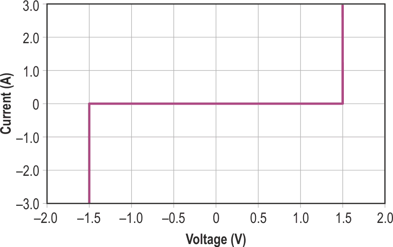

Static measurements are in Table 2 and Figure 5 is the corresponding graph. Figure 5 shows symmetrical voltage limiting.
Table 2. Measurements taken for the
circuit in Figure 4
Voltage, in V Current
1.4994 3 A
1.4994 300 mA
1.4995 30 mA
1.4995 3 mA
1.4994 302 µA
1.4995 30.5 µA
1.4995 3.05 µA
1.4995 350 nA
1.4995 50 nA
1.3335 10.3 nA
–1.4000 –10 nA
–1.5049 –3 µA
–1.5049 –30 µA
–1.5049 –300 µA
–1.5049 –3 mA
–1.5049 –30 mA
–1.5049 –300 mA
–1.5049 –3 A
Curve for circuit in Figure 4, limiting voltage is very symmetrical about 0 V.
Figure 5. Curve for circuit in Figure 4, limiting voltage is very symmetrical
about 0 V.

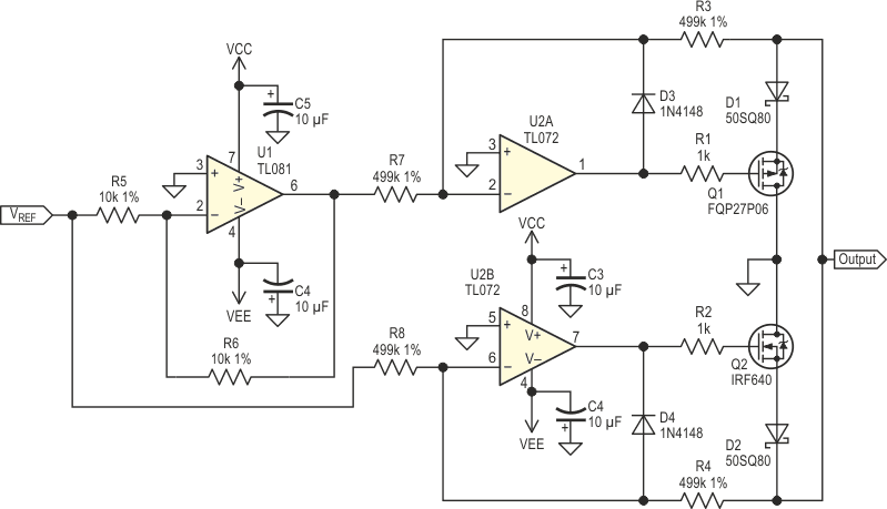

An improved circuit which does not saturate the op amp is in Figure 7. The main op amps U2A and U2B are now unity gain inverting amplifiers. Diodes D3 and D4 limit the op amps output voltage to 0.7 V in saturation [7]. Op amp U2A output now has to slew only from +0.7 V to –4 V. Since the input resistor R3 will load the output, it is selected to be twice the minimum acceptable resistance specified of 200 kΩ, I had 499k 1% resistors on hand, so I used those. Waveforms are taken using only the positive limiter part from Figure 7, with 200k resistors for R3 and R7.
Schematic symmetrical shunt voltage limiter with the final op-amps operated in inverting mode.
Figure 7. Schematic symmetrical shunt voltage limiter with the final op-amps operated in inverting mode.
In Figure 8, oscilloscope CH1 is the circuit output voltage and CH2 is U2A output. The response is 5 µs, about four times faster than with the initial circuit.

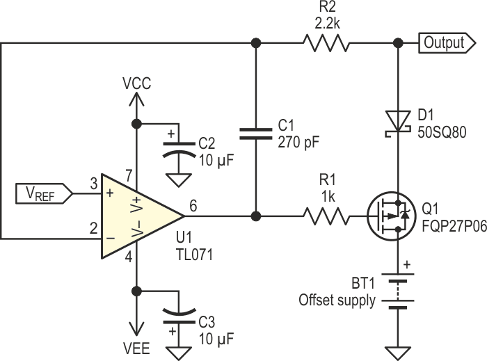

If you need to limit the voltage to a value lower than 700 mV, the voltage lost in the diode will make it almost impossible to meet that requirement with either circuit. But if you connect the P-channel MOSFET drain to a negative voltage source, then any voltage limit is possible even 0 V. The same approach can be used for the N channel MOSFET. The circuit in Figure 10 does just that with performance comparable to the circuits above. The offset voltage source, battery B1 in schematic, should be capable of supplying the required current.
Schematic of a voltage limiter capable of operating below 1 V.
Figure 10. Schematic of a voltage limiter capable of operating below 1 V.

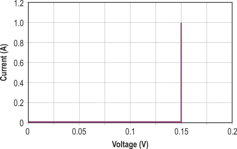

Table 4 gives the results with a 150-mV reference and an offset power supply of 1.8 V. Current versus voltage curves at high current, up to 1 A, are graphed in Figure 11. Here again the circuit shows sharp knee, low leakage and constant limiting voltage. The same technique can be used with the schematic in Figure 7. For limiting voltage values below approximately 1 V, error budget calculations should govern your selection for the op amps offset voltage and bias current maximum values.
Table 4. Measurements taken for
Voltage, in mV Current
150.69 1 A
150.58 300 mA
150.55 100 mA
150.52 30 mA
150.51 9.5 mA
150.51 3.1 mA
150.51 930 µA
150.51 190 µA
0.00 0 µA
Curve for circuit in Figure 10.
Figure 11. Curve for circuit in Figure 10.
