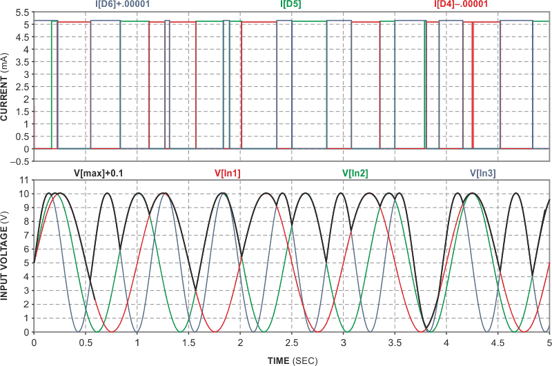

Op amps IC1B and IC1C function as high-input-impedance inverting comparators. Each “sees” the highest input voltage on its inverting input and one of two lower input voltages, IN2 and IN3, on its noninverting input and delivers an output voltage near that of the negative-supply-voltage rail. Thus, only IC1A delivers a positive-voltage output to MOSFET Q1 's gate, and IC1B and IC1C deliver negative outputs to the gates of Q2 and Q3. Q1 turns on, lighting LED D4 and drawing approximately 5 mA to develop 11 V across R3, which guarantees that Q2 and Q3 and their correspond ding LEDs remain off. The voltage that develops across R1 represents the largest voltage of the three inputs, and resistor R4 and capacitor C1 form a lowpass filter that reduces high-frequency noise that the sensor cables pick up. Voltage follower IC1D buffers the filter's output voltage. Figure 2 shows the results of an LTSpice simulation featuring three sinusoidal inputs and the resultant analog output summed with a small dc-offset voltage for clarity.
Three sine waves of different frequencies provide input voltages (lower traces) that evoke the greatest-of-three response in the current through R2 (top trace, in which colored horizontal segments match the largest inputs).
Figure 2. Three sine waves of different frequencies provide input voltages (lower traces) that evoke the greatest-
largest inputs).
