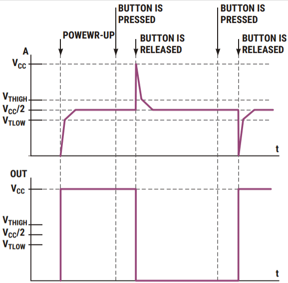

A waveform shows the signal plot in different points of the circuit.
Figure 2. A waveform shows the signal plot in different points of the circuit.
When you first press the button, capacitor C quickly charges to VCC because the inverter output is high. When you release the button, high logic voltage appears across the capacitor on the inverter input. Thus, its output goes low. The capacitor discharges through resistor R2 down to VCC/2. When you press the button for the second time, capacitor C quickly discharges from VCC/2 to 0 V because the inverter’s output is low. When you release the button again, the discharged capacitor shunts the inverter input, thus forcing its output high. The capacitor charges up through resistor R1 to VCC/2.Figure 2 shows the waveforms.
