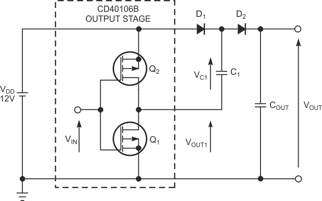

The circuit in Figure 1 overcomes the transformer-related problem, thanks to a transformerless, switched-capacitor topology that requires only off-the-shelf components. You can describe the operating principles of the circuit by first considering the behavior of a single switched-capacitor cell and then extending the concept to an N-cell voltage multiplier. Figure 2 represents the equivalent circuit of the first switched-capacitor cell.
This circuit illustrates the operating principle of the basic voltage-doubler cell.
Figure 2. This circuit illustrates the operating principle of the basic voltage-doubler cell.
The two complementary MOSFETs, Q1 and Q2, mounted in a push-pull configuration, represent the output stage of one CD40106 Schmitt-trigger inverter. The input signal, VIN, drives the push-pull stage, producing a 0 to 12 V square wave at 150 kHz. If you assume that VIN is 12 V during the first half-period, then Q1 is on, and Q2 is off. Consequently, D1 is forward-biased, and C1 charges positively to VC1 = VDD – VD, where VD is D1's forward-voltage drop (0.7 V). Meanwhile, D2 is forward-biased, and COUT charges to VOUT = VDD – 2VD. During the second half-period, the states reverse: VIN is 0 V, Q1 is off, and Q2 is on, thus connecting the negative terminal of C1 to the supply voltage. This action forces the positive terminal of C1 to elevate itself to a voltage higher than the supply voltage, VDD. D1 now becomes reverse-biased and allows C2 to charge up again through D2. If you assume that COUT's value is considerably lower than the value of C1, then you can calculate that VOUT attains the value
Thus, assuming VDD >> VD, you can see that the circuit in Figure 2 acts as a voltage-doubler cell.
