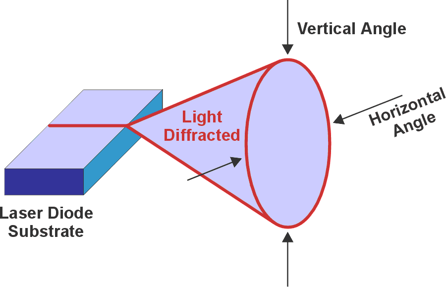

- An optical component may be needed to correct the astigmatism of the laser light-emitting diode (LED). Uncorrected, the laser beam will diverge, which reduces the maximum sensing distance. When corrected, the light beam is said to be collimated.
Laser-beam divergence occurs in semiconductor-based laser LEDs because their mechanical structure forces the light to diffract as it leaves the semiconductor substrate. The slit needs to be longer in the horizontal direction than in the vertical direction (Figure 1).
| Figure 1. | Horizontal versus vertical diffraction angles of a semiconductor laser LED. |
Most laser LEDs are vertically stacked so that the horizontal slit creates a diffracting beam, which has a wider vertical angle than the horizontal angle.
As a first approximation, consider a diffracted beam angle of 30 to 40 degrees on the perpendicular axis and 10 degrees for the parallel axis. The difference in divergence between the vertical and horizontal axis leads to the astigmatism requirement.

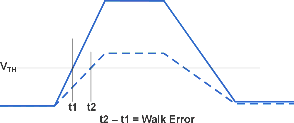

Beyond input noise, electrical noise and jitter, a specific accuracy error for the pulse time-of-flight measurement is called the “walk error” (Figure 2) [4]. The walk error is best understood when considering the impact of variable reflectivity levels on the received signal. Since the rise time of the transmitted signal is finite, the rise time of the received signal will be the same. This means that the received signal needs to pass a given threshold (VTH in Figure 2) at different times (t1 and t2, respectively), depending on its full amplitude.

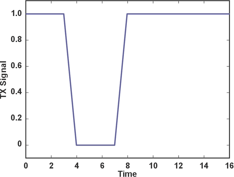

| Figure 3. | Arbitrary transmit pattern 11001111. |

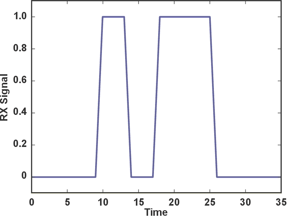

Because there are limited publications about how to use the captured information at zero crossing, a very basic definition can be developed for the signal processing of the information obtained from the rising and falling edges of the TDC. This processing is named time-domain correlation. Time-domain correlation is similar to a classical correlation in that it becomes possible to compute time-of-flight, even in the presence of noise. However, it also differs because the time-domain correlation does not include amplitude information so it must be artificially added. Consider that the signal is 0 before and 1 after a rising edge, and reciprocally 1 before a falling edge and 0 after. Keeping in mind Logan’s theorem, a simple signal reconstruction has been built that is suited to the binary logic of microcontrollers and digital logic. This concept is illustrated in Figure 3 for a typical signal with arbitrary time units. In absence of any noise, Figure 4*) shows the expected output from the comparator.
| Figure 4. | The output of the comparator in the absence of noise*). |

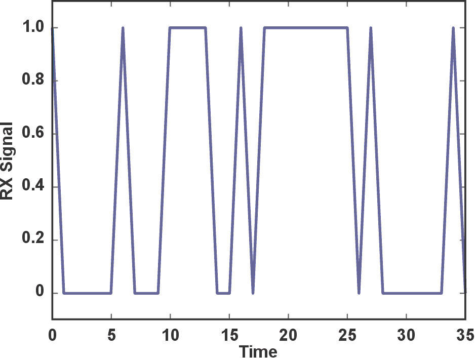

Once the MCU reads the TDC values, the memory will hold [10,+], [14,–], [17,+], etc. The number is the time stamp and the symbol indicates if the edge is rising or falling. A simple subroutine could expand this into an array, which is reflected in Figure 4*). Assuming now that the signal chain is noisy, a possible output of the comparator is shown in Figure 5. The comparator’s threshold should typically be three times above the root-mean-square (RMS) noise floor or more, depending on the compromise between false positive and false negatives. Now the threshold can be lowered significantly, reducing the amount of false negatives.
| Figure 5. | Output of the comparator feeding the TDC in the presence of noise. |

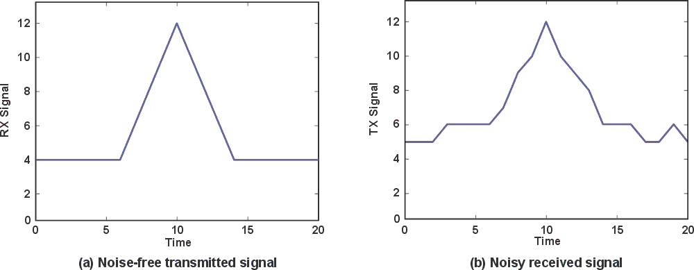

With a classical approach, the MCU subroutine may consider a time-of-flight of five of the arbitrary time units. Figure 6 shows a simple cross correlation between the noise-free transmitted signal and the noisy received signal. Note that the correct time of flight of 10 units is clearly the maximum of the correlation, which is the intended result.
By comparing Figure 6b to Figure 5, a much more robust estimation of the time-of-flight is apparent in Figure 6b. This is because the first rising edge in Figure 5 (or the second or third depending on implementation) is considered the time-of-flight, which can be easily corrupted by noise.
