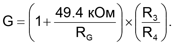

IC1 maintains its high-linearity performance with a 5 V supply because its front end is configured to operate from dual supplies, and the circuit in Figure 1 relaxes its output drive level. Because IC3 level-shifts the entire circuit above ground, you measure the circuit's final output voltage with respect to 2.5 V, not 0 V. An expression for the gain of this composite IA combines the gain equations of IC1 and the gain-of-3 inverter:
As shown in Figure 1, choosing RG =1.5 kΩ yields a gain-of-100 composite configuration. You can obtain other gain values with different values of RG, as shown in Table 1. Even though it's not necessary that the inputs to the circuit operate at the positive rail or ground, wide input common-mode operation is always beneficial.
