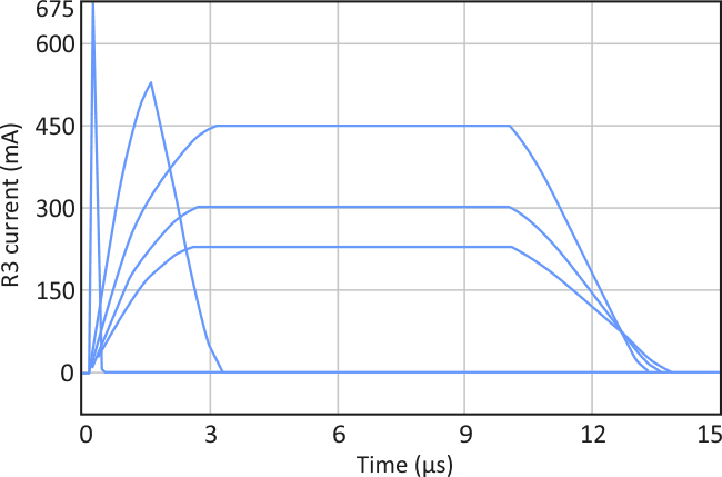

The circuit permits full output at any duty cycle, as long as the resistive heating element’s resistance exceeds a minimum value. Below that value of load resistance, the latch allows only a minuscule spike of current on each “on” transition (Fig. 2). The circuit is quite sensitive to the critical resistance value and is, of course, self-recovering as long as the PWM input is present. (If the PWM achieves 100% “on” time, the latch won’t reset until the next pulse occurs.) No significant heatsinking is required.
If the load resistance is below a minimum value, the drive circuit
Figure 2. If the load resistance is below a minimum value, the drive circuit allows only
a small spike of current on each “on” transition.
The circuit can be scaled to different voltage and current levels. However, it may not be appropriate for power levels much higher than 25 W, due to the increasing magnitude of the spike current that appears at short circuit. It’s also not a good choice for driving an incandescent lamp. That is, unless the cold resistance of the lamp is high enough to allow the PWM to unlatch and deliver current.
