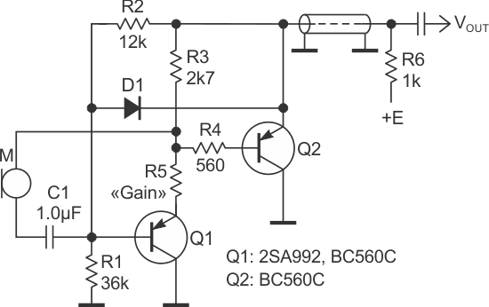

The circuit in Figure 1 is suited for inductive sources such as a dynamic microphone, transformer or inductance sensor/pick up.
A simple amplifier circuit suited for inductive sources such as a dynamic microphone, transformer or inductance sensor/pick up.
Figure 1. A simple amplifier circuit suited for inductive sources such as a dynamic
The circuit is versatile; its gain can be varied from 1 to about 130. it also has a wide power range (approximately 5 to 15 V). It uses no electrolytic capacitors, which improves reliability.
A low-impedance dynamic microphone can be connected to the input with or without any matching transformer. The circuit is powered through a two-wire output cable, i.e., the load resistor is separated from the circuit by a (screened) cable.
The maximum gain is about 130. This rather high value is provided by the common emitter input stage (low noise transistor Q1) with dynamic load R3, Q2.
While the maximum gain is achieved when R5 = 0 Ω, the gain can be reduced by choosing a non-zero value of resistor R5, which introduces a local feedback. Such local feedback also improves the circuit linearity.
For example, when R5 = 180 Ω, gain is about 60. The emitter follower (Q2) also provides a low output resistance for the circuit.
Like any other device connected to an inductance or long connecting cable, the circuit can be subject to overvoltages on its terminals. Diode D1 protects both input and output to avoid the related damage.

The modified circuit to get a gain of about 1.
Figure 2. The modified circuit to get a gain of about 1.
Figure 2 shows how the circuit can be modified to get the gain of about 1.
