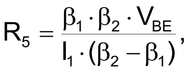

The dc gains of the two transistors usually are not perfectly matched, resulting in a slight output offset voltage. To compensate, note the addition of base-emitter resistors R5A and R5B in Figure 1. To reduce the output offset voltage to almost zero, you can add R5A or R5B, not both. As an example, assume that β2 > β1; R5B is then used at Q2. If Q1 has the higher beta, R5A would be used at Q1. You can estimate R5’s value from the following equation:
where β1 and β2 refer to the beta of Q1 and Q2.
When the output is balanced with the help of R5, input bias current is also minimized because the currents I3 and I4 cancel out each other.

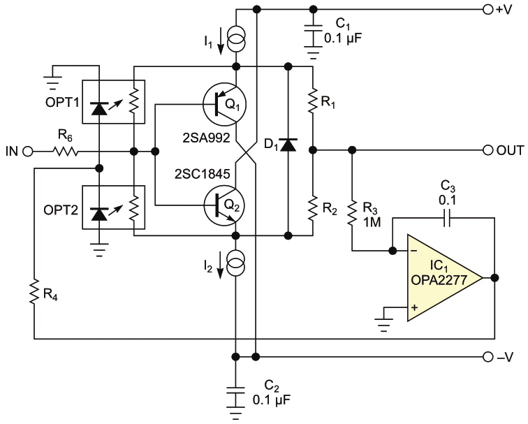

| Figure 3. | This circuit is a version of the circuit shown in Figure 1 that will automatically servo the output to a voltage close to zero. |
The circuit shown in Figure 3 is a version of the circuit shown in Figure 1 that will automatically servo the output to a voltage close to zero. The integrator, IC1, averages the output voltage but does not pass the ac signal, because it is acting like a high-pass filter; its corner frequency, fC, can be calculated from this equation:
In this circuit, fC is approximately 1.6 Hz.
The output of the integrator drives an optocoupler that uses a photoresistive element on the output side. This resistor replaces the upper and lower R5 resistors. The circuit in Figure 3 provides an output offset voltage of almost zero even with an input offset voltage applied, as long as it isn’t too high. The op amp, IC1, should have low noise, low bias current, and low offset voltage; also, resistor R3 and capacitor C3 should be high-quality, stable devices.
