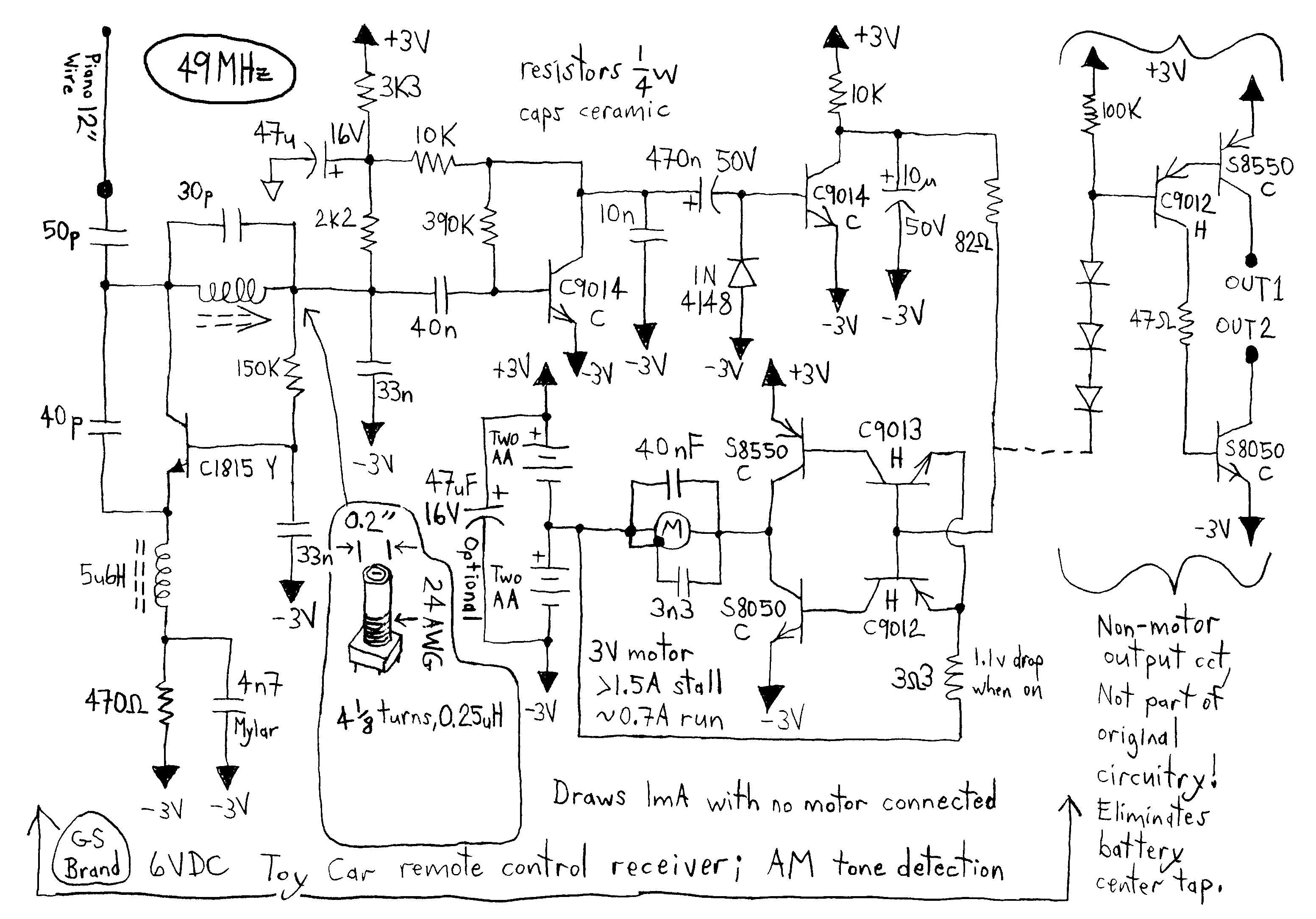

The 6 volt GS super regenerative receiver. Note that the 6 volt supply which consists of 4 AA cells is center tapped and feeds a 3 volt motor. Shown at 27MHz 40MHz and 49MHz:

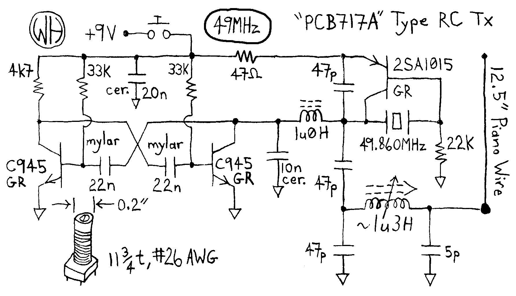

Here is the 9 volt WH crystal controlled transmitter. It is unremarkable. Shown below at 27MHz and 49MHz:
The 6 volt WH super regenerative receiver. The 6 volt supply consists of 4 AA cells and drives a full bridge to run a 6V motor. A zener provides a nice stable voltage to the RF transistor. Shown at 27MHz and 49MHz:

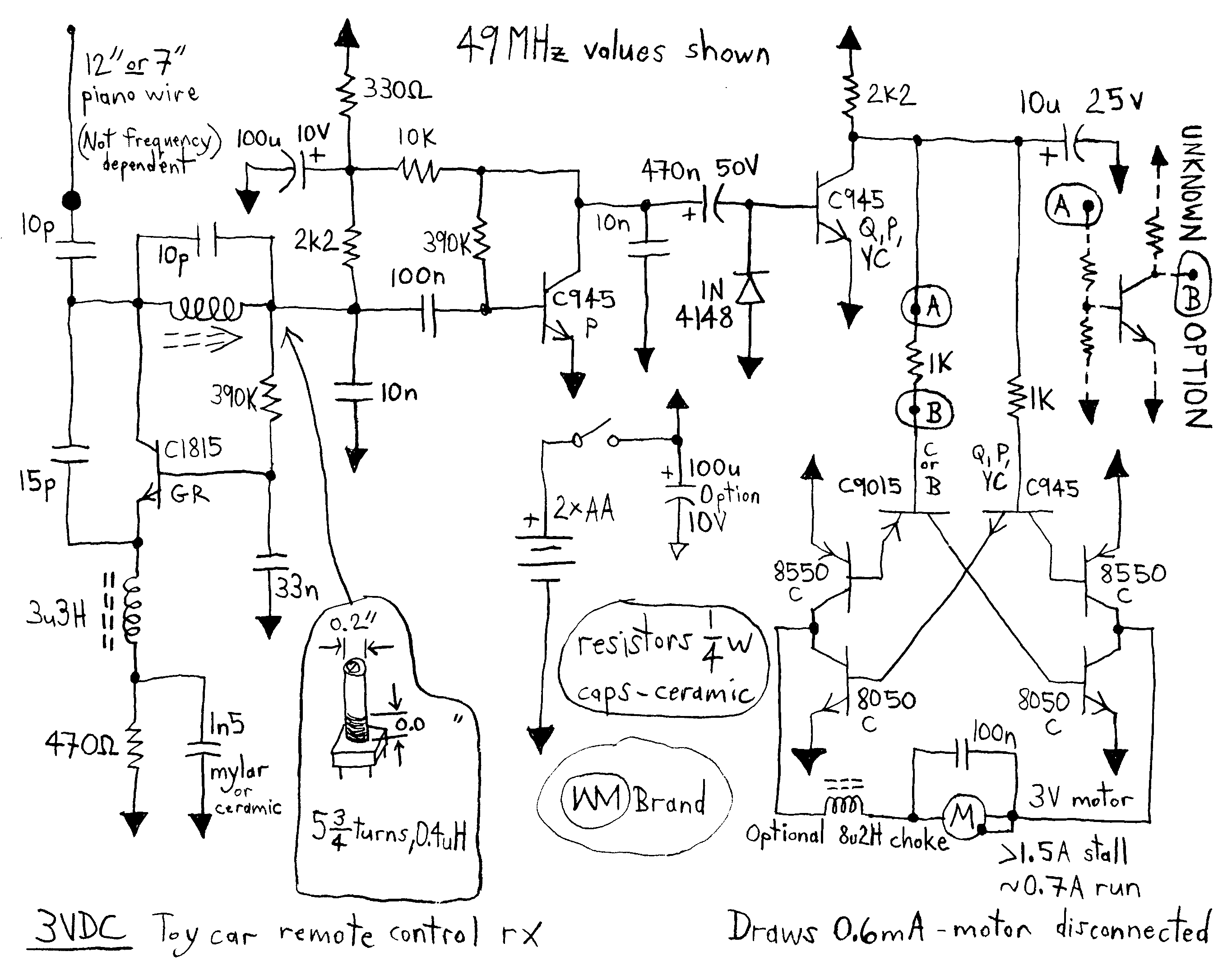

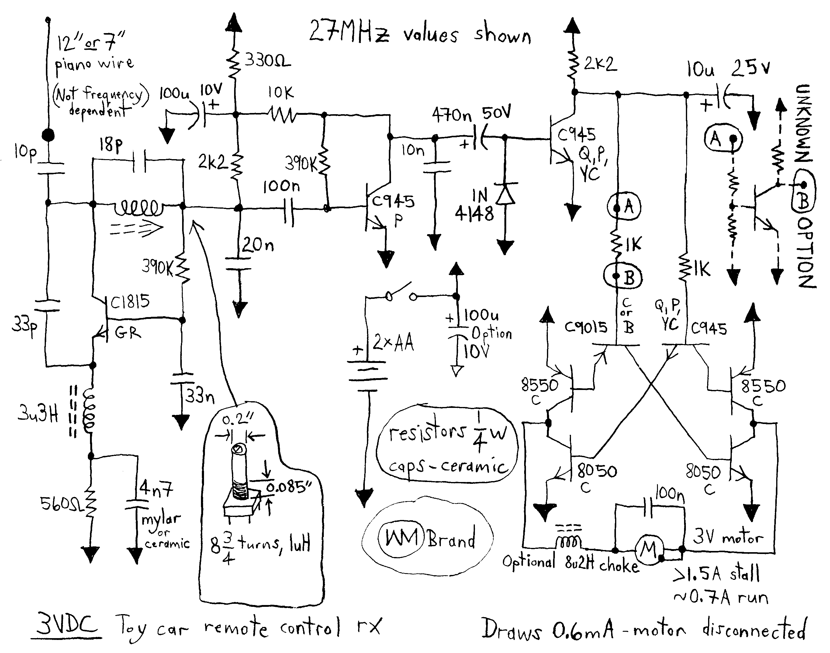

The 3 volt WM super regenerative receiver. The 3 volt supply consists of 2 AA cells drives a full bridge to run a 3V motor. Shown at 27MHz and 49MHz:
