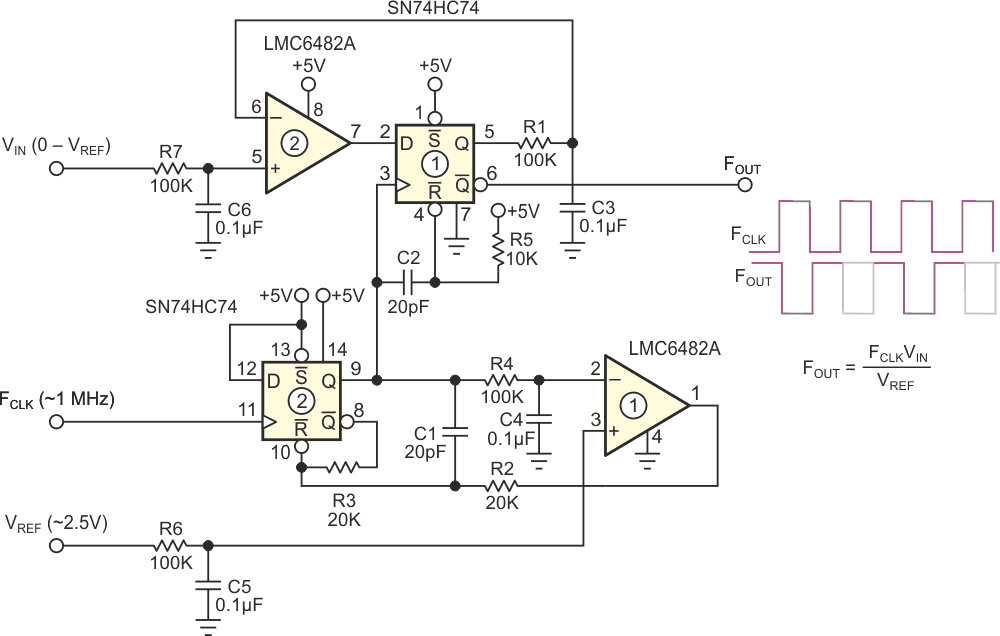

The high speed synchronous VFC.
Figure 1. The high speed synchronous VFC.
Here’s how it works:

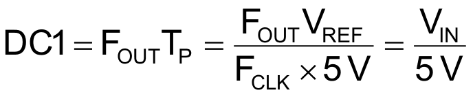

D-type flip-flop #1 (FF#1) in the HC74 forms a feedback loop with op-amp #2 in the 6482 acting as a high-resolution comparator and with the high speed (~ns transition times) of the HC74 switches acting to apply 0/5 V to Q1 according to the 0/1 state of the op-amp output when the FF is clocked. The duty cycle (DC1) of the FF is thus time averaged by R1C3 and servoed by the feedback loop to force
and
But a logic supply is typically a poor choice for a conversion reference voltage, so if this were all there was to the story, expectations for VFC accuracy would likewise be poor. We need a trick to compensate for the inevitable inaccuracy and noise in the +5 V supply.
The needed compensation is provided by FF#2 implementing another feedback loop.

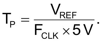

FF#2 is connected to form a monostable (one-shot) triggered by FCLK, applying 5 V pulses to the R4C4 averaging network with pulse duration (TP) determined by R2, R3, C1 network and op-amp #1. The voltage is averaged by
Op-amp #1 compares this average to VREF and forces TP so that
Because both FFs occupy the same chip, accuracy-affecting parameters like propagation delays, transition times, and voltage offsets will be very similar and track well over temperature and supply voltage variations, making compensation very effective.
These TP duration pulses become the clock reference for FF#1, thus…
…yielding (finally) the hoped-for classical synchronous VFC conversion equation…
The resulting VFC has some useful characteristics besides high speed (for a VFC). This includes a good linearity, a tolerance of VREF in the range of 1 to 4 V, F  from 500 kHz to 3 MHz, operation from a single “5V+”, a 3 to 6 V supply, a low power consumption (~10 mW), very high input impedances (e.g., less than 1 pA input current on VIN and VREF), and no critical or high-precision passive components.
Finally, all parts needed to build it are generic, readily available, and cheap! Total parts cost is ~$10, while by contrast the similar speed AD652, by itself, costs ~$40.
