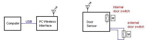

Block Diagram

Door Sensor Hardware Design Details
The door sensor consists of the following main hardware pieces,
- Atmel ATtiny45 microcontroller
 - Maxstream XBee Zigbee transceiver
 - Reed switches and magnets
 - 3.0V Lithium battery
 - 3.0V step-up switching regulator
The ATtiny45 monitors the open/closed condition of two reed switches. The open/closed states are formatted into a message and sent out the ATtiny45’s UART interface to the XBee. The XBee wirelessly sends the message to another XBee node.
Circuit Summary
- Door open/closed state is determined using reed switches in a resistor divider circuit.
 - The XBee wirelessly sends data to compatible nodes.
 - Interface between ATtiny45 and XBee is TTL level (3.0V) UART including Tx and Rx. CTS-RTS handshaking is not used since system protocol is very simple (single byte).
 - The ATtiny45’s firmware controls the power state of the XBee at the SLEEP_RQ pin.
 - 3.0V battery + step-up regulator supplies power to the circuit.
