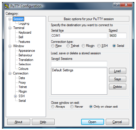

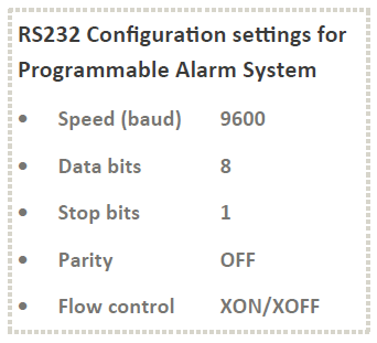

  8. Download and install PuTTY on to the target computer and setup the "Serial" connection with 9600 baud rate.
  9. Press "2" and enter into the "Parameter Setup" mode. Configure all the parameter options with the appropriate settings.

настройка PuTTY
PuTTY configuration setup for Programmable Home Security Alarm System
