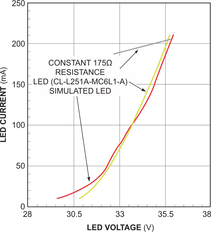

Figure 2. The simulated LED approximates the turn-on characteristics of a real LED.
A constant-resistance load approximates a real LED load at only one
point on the curve.
Figure 2 compares the simulated LED’s current and voltage characteristics to those of a real LED and a constant resistance. The soft turn-on of the simulated LED accurately mimics that of a real LED. Furthermore, the simulated LED quickly retunes to test minimum and maximum LED characteristics, thus giving you confidence that the circuit will work over all load conditions.
