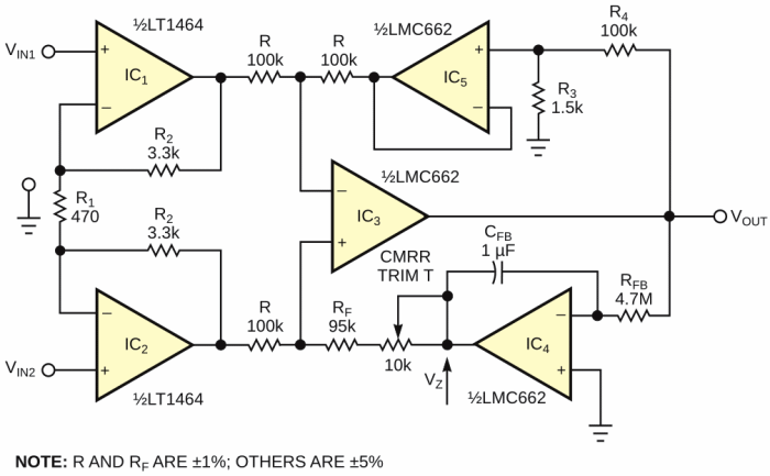

This instrumentation amplifier can accommodate a differential-input range of ±0.34 V.
Figure 2. This instrumentation amplifier can accommodate a differential-input range of ±0.34 V.
The only drawback of this topology is apparent in the expression for fC, the highpass cutoff frequency. You multiply this frequency by the gain of the active-feedback stage. Therefore, to maintain a given cutoff frequency, you must multiply the time constant by a factor equal to the active-feedback stage gain. This factor can be an issue in processing signals whose spectrum includes low-frequency components. In such applications, RFB and CFB can reach prohibitive values. Consequently, you must make a trade-off between the time constant and the active-feedback stage gain. The component values in Figure 2 are a typical example of such a trade-off: The values are for an EEG (electroencephalogram) amplifier with ±5 V split power supplies. The amplifier has a differential gain of 1000 and a highpass cutoff frequency of 2.3 Hz, and it can handle a differential-input dc-voltage range of ±0.34 V.
To obtain this performance, you set the active-feedback stage gain and the differential-amplifier gain, respectively, to 67.6 and 15. With these gain values, the noise performance of the ac-coupled instrumentation amplifier of Figure 2 is similar to that of a classic instrumentation amplifier. This situation occurs because the autozeroing and active-feedback stages, IC4 and IC5, are after the input differential stage, IC1 and IC2. Consequently, the gain of the differential stage roughly divides their respective noise contributions, which are therefore negligible. You can use several low-noise op-amps for IC1 and IC2. For portable biotelemetry applications, the LT1464 is a good compromise for input-noise density, noise-corner frequency, input-bias current and current drain. (Respectively: VNOISE=26 nV/√Hz, fC=9 Hz, IBIAS=0.4 pA, and ICC=230 μA.)
A theoretical analysis using the LT1464's noise parameters shows that under worst-case conditions, the input-noise voltage should not exceed 11 µV rms. Tests on prototypes confirm this prediction; the tests effectively measure input-noise voltages of 3 to 6 µV rms. To sum up, an ac-coupled instrumentation amplifier with active feedback is well-suited for applications requiring high differential gain, a capability for handling large differential-input dc voltages, and low-noise performance.
