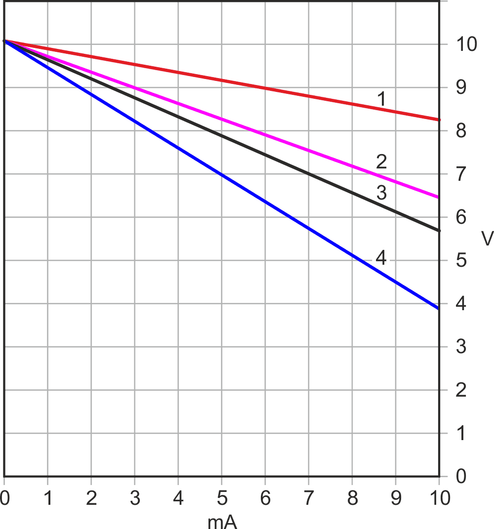

The dependence of the two output voltages on loading is graphically summarized in Figure 3.
The 25 kHz multivibrator 10 V p-p waveshapes.
Figure 3. Output voltages under four loading scenarios:
(1) +10 V output with +10 V loaded 0 to 10 mA, –10 V unloaded;
(2) +10 V output with both +10 V and –10 V loaded 0 to 10 mA equally;
(3) –10 V output with –10 V loaded 0 to 10 mA, +10 V unloaded;
(4) –10 V output with +10 V and –10 V loaded 0 to 10 mA equally.
