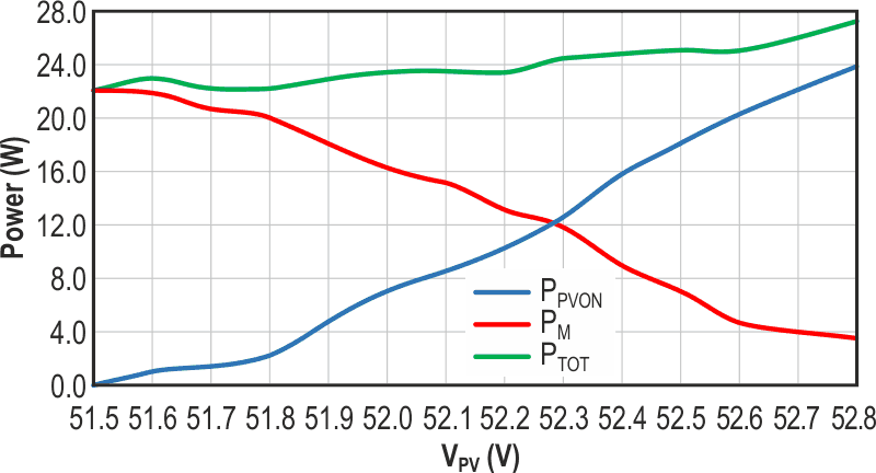

Testing was done at various sunlight intensities. For any given sunlight intensity, VPV, IPV, VM, IM, etc., are measured. Figure 5 shows the variation of PV power (PPVON), converter power (PM), and total power (PTOT) with the converter ON.
Plots of PV power, converter power, and total power with the converter turned ON at 52 V are provided.
Figure 5. Plots of PV power, converter power, and total power with the converter turned ON
Note that at VPV = 51.5, the maximum power drawn from the converter is about 22 W. This is just an initial setting. If required, it can be increased by boosting the converter output voltage. As we move toward higher VPV voltage, the total power goes up somewhat due to more power coming from the PV.

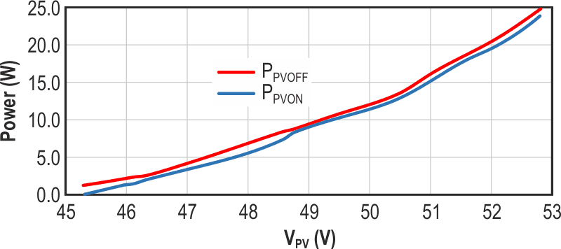

When readings were taken for the converter in Figure 5, at the same time and at the same sunlight intensity (in quick succession), another set of readings were taken with the converter OFF. To study the behavior of the PV array, PPVON and PPVOFF were plotted in Figure 6.
This PV power plot shows when the converter is OFF and when the converter is turned back ON.
Figure 6. This PV power plot shows when the converter is OFF and when the converter
is turned back ON.
Note that when the converter is turned ON, the variation in VPV is restricted to a narrow range from 51.5 to 52.8 V. When the converter is turned OFF, the VPV range is much wider, from 45.4 to 52.8 V. PPVOFF is plotted with its corresponding VPV range of 45.4 to 52.8 V. The PPVON plot from Figure 5 is replotted in Figure 6, against the VPV range of 45.4 to 52.8 V, for the sake of comparison only.
The plots clearly reveal that when the converter is OFF, PV power is slightly higher. As discussed earlier, the SDL itself follows maximum power point. Hence, when we turn the converter ON, maximum power point gets disturbed due to a change in VPV. Therefore, about a 1-W reduction in power output from the PV panels is observed when the converter is turned ON.

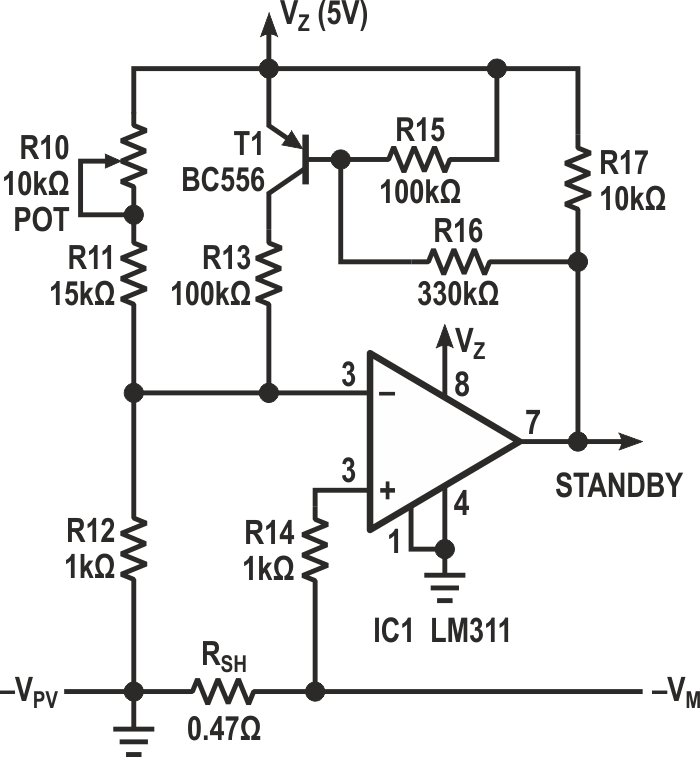

In Figure 3, components shown with * marks are employed to generate the Standby signal. Current-sensing resistor RSH is used to sense the PV current. When PV current exceeds a threshold value (user-settable), the Standby signal (comparator output) goes high. This signal is connected to the converter, which then goes into Standby Mode. Components RZ (3.3 kΩ, 2 W) and DZ (Zener 5.1 V, 1 W) are used to generate the 5-V power supply (VZ) for the comparator.
Figure 7 shows the circuit diagram of the comparator. It consists of comparator IC1 (LM311). The reference voltage is connected to the inverting terminal Pin 3 using R10, R11 and R12. This reference voltage is user-settable with the help of potentiometer R10. Pin 3 also gets current from resistor R13, which is controlled by PNP transistor T1 (BC556). The non-inverting terminal Pin 2 is connected to the current-sensing resistor RSH.
The comparator circuit with hysteresis generates the Standby signal.
Figure 7. The comparator circuit with hysteresis generates
the Standby signal.
When the drop across RSH exceeds reference voltage at Pin 3, the Standby signal goes high. In addition, T1 turns OFF and the reference voltage drops, thus introducing hysteresis. The T1 and R13 circuit is required because, in this case, the current signal must be connected to the non-inverting terminal. Therefore, this terminal can’t be used to introduce hysteresis, as is usually the case.

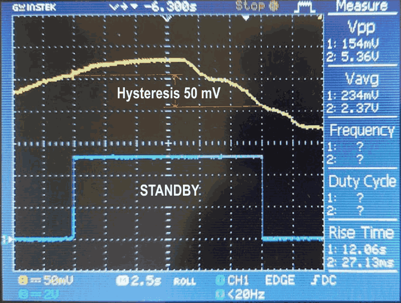

Figure 8 shows the capture of PV current (yellow) and Standby signal (blue). A 50-mV hysteresis is generated, which translates to about 106 mA of PV current. When the Standby signal is high, it will not become low unless the PV current reduces by 106 mA. This will diminish the unwanted chattering of the Standby signal.
Standby signal: yellow trace - PV current 106 mA/div; blue trace - Standby signal 2 V/div., hysteresis 50 mV (106 mA).
Figure 8. Standby signal: yellow trace – PV current 106 mA/div; blue trace –

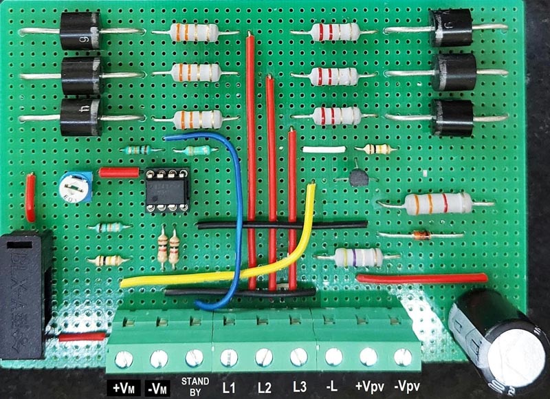

Figure 9 shows the assembled PCB as per the circuit diagram in Figure 3. It includes the PV-Pushback circuit as well as the Standby signal generator circuit. Interconnections to this PCB are available on the 9-pin terminal strip. The power supply from the converter is connected through a fuse for safety.
This is the assembled PCB for a lighting system based on the PV-pushback-effect.
Figure 9. This is the assembled PCB for a lighting system based on the PV-pushback-effect.

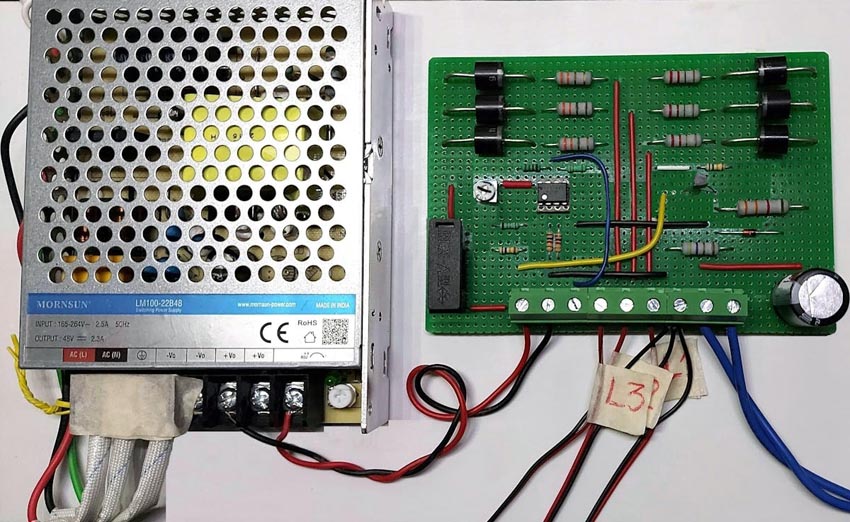

In Figure 10, the PCB and the AC-DC converter are mounted on same baseplate.
In this circuit, the AC-DC converter is mounted on a single board.
Figure 10. In this circuit, the AC-DC converter is mounted on a single board.

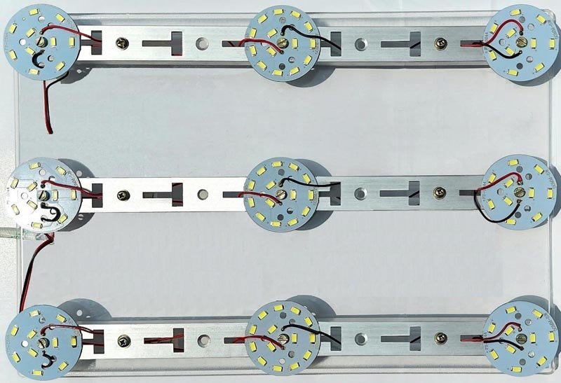

Figure 11 shows the lamps L1, L2 and L3 mounted on a baseplate. Each lamp is made using three metal-core PCBs having white LEDs. Two round PCBs have five LEDs each and the middle round PCB has seven LEDs. Overall, each lamp has 17 LEDs.
Three LED lamps are used in the demonstration. Each lamp has 17 white LEDs.
Figure 11. Three LED lamps are used in the demonstration. Each lamp has 17 white LEDs.

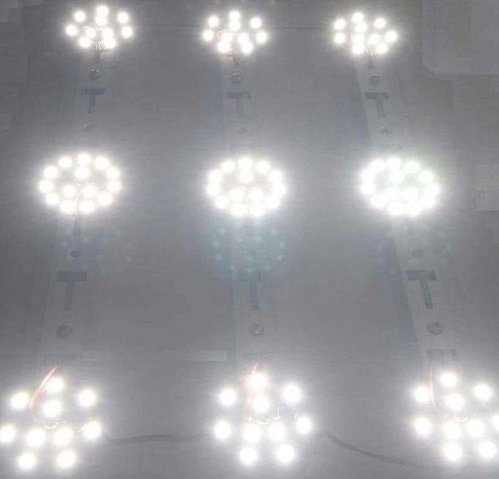

Figure 12 illustrates the lamps turned ON, and Figure 13 shows the complete system.
Lamps L1, L2, and L3 provide constant light output using the PV-pushback-effect.
Figure 12. Lamps L1, L2, and L3 provide constant light output
