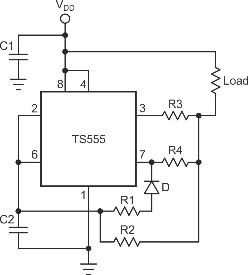

The circuit in Figure 2 combines the sink currents of both the Output and the Discharge pins, which allows us to double the output current. Resistors R3 and R4 are part of the load, they limit the sink current to a safe value.
| Figure 2. | Circuit that combines the sink currents of the Output and Discharge pin of the, doubling the output current. |
The price for this doubling is some accuracy degradation: Now, the circuit is a bit more susceptible to the power voltage variations. Nevertheless, this downside accuracy a satisfactory tradeoff for many applications.
