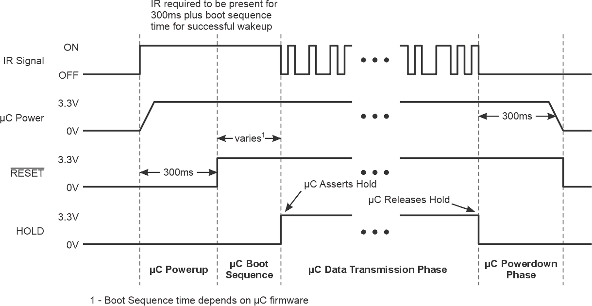

Upon detecting an IR signal and after a suitable delay (300 ms in this case), the circuit connects power to the microcontroller and applies a reset signal to it, Figure 2.
| Figure 2. | When the Figure 1 circuit detects an IR signal, it powers and resets the microcontroller. After the IR transmission ends, the microcontroller suspends itself by releasing the Hold line. |
After power-up, the microcontroller must assert its Hold line to prevent the circuit from returning to standby mode when the IR transmission ends. U2 buffers and inverts the IR transmissions. When the microcontroller has completed its tasks and no more IR transmissions are present, it returns the circuit to standby mode by de-asserting the Hold line.
