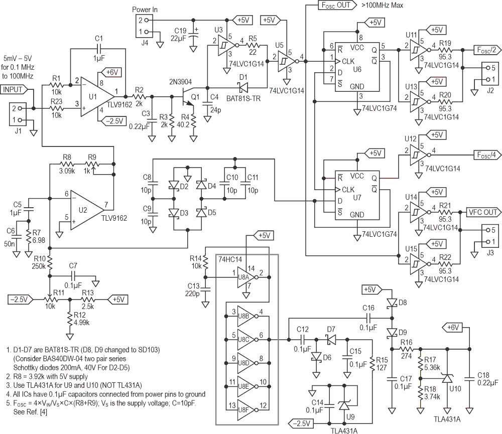

I added two 50-ohm outputs to the schematic of my published voltage-to-frequency converter (VFC) circuit [1] (Figure 1). Then, I designed a PCB, purchased the (mostly) surface-mount components, loaded and re-flow soldered them onto the PCB, and then tested the design.
VFC design that operates from 100 kHz to beyond 100 MHz with a single 5-V supply, providing square wave outputs at ½ and ¼ the main oscillator frequency.
Figure 1. VFC design that operates from 100 kHz to beyond 100 MHz with a single 5-V supply, providing square wave outputs at ½

The first unexpected problem was that the NE555 timer did not provide sufficient drive to the voltage inverter circuit and the voltage doubler circuit. This one is on me; I didn’t look carefully at the datasheet, which says it can supply a lot of output current, but at high current, the output voltage drops so much that the inverter and the doubler circuits don’t provide enough output voltage. And the LTspice model I used for simulation was a very unrealistic model. I recommend that it not be used!
I fixed this by using a 74HC14 Schmitt trigger chip to replace the NE555 timer chip. The 74HC14 provides plenty of current and voltage to drive the two circuits. I implemented the 74HC14 circuitry as an outboard attachment to the main PCB.
I changed the output of the voltage doubler circuit to a regulated 6 V (R16 changed to 274 Ω and R18 to 3.74 kΩ, and D8, D9 changed to SD103). This allows U1 to operate with an input voltage of up to about 5.9 V. Also, I substituted a TLV9162 dual op-amp for U1/U2 because the cost of the TLV9162 is much less than that of the LT1797.
With the correct voltages supplied to U1/U2, I began testing the circuit, and I found that the oscillator would hang at a frequency of about 2 MHz. This was caused by the paralleled Schmitt trigger inverters. One inverter would switch before the other one, which would then sink the current from the inverter that had switched to the HIGH output state, and the oscillator would stop functioning. Paralleling inverters, which are driven by a relatively slowly falling (or rising) input signal, is definitely not a viable idea!
To fix the problem, I removed U4 from the circuit and put a 22-Ω resistor in series with the output of inverter U3 to lessen the current load on it, and the oscillator operated as expected.
I made some changes to the current-to-voltage converter circuit to provide more adjustment range and to use the optimum values for the 5-V supply. I changed R8 to 3.09 kΩ, potentiometer R9 to 1 kΩ, and R13 to 2.5 kΩ.

There are two adjustments provided: R9 is an adjustment for the current-to-voltage converter U2, and R11 is an offset current adjustment.
I adjusted R9 to set the oscillator frequency to 100 MHz with the input voltage set to 5.00 V, and then adjusted R11 at 2 MHz.

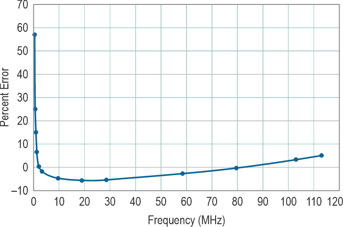

The percent error of the circuit increases at the lower frequencies; possibly due to diode leakage currents, or nonlinear behavior of the frequency to voltage converter consisting of D2 – D4 and C8 – C11?

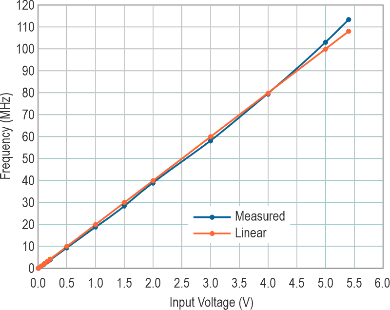

The frequency from 1.07 MHz to 103.0 MHz versus input voltage from 50 mV to 5.00 V.
Figure 3. The frequency from 1.07 MHz to 103.0 MHz versus input voltage from 50 mV to 5.00 V.

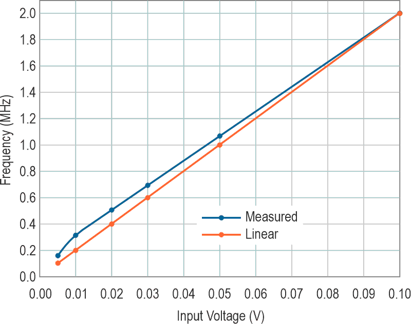

The frequency (up to 2 MHz) versus input voltage when VIN ≤ 0.1 V.
Figure 4. The frequency (up to 2 MHz) versus input voltage when VIN ≤ 0.1 V.
The frequency versus input voltage plot is not as linear as expected, but it is pretty good over a wide range of input voltage from 50 mV to 5.00 V for a corresponding frequency range of 1.07 MHz to 103.0 MHz (Figure 3 and Figure 4). The percent error versus frequency is shown in Figure 5.
The percent error versus frequency.
Figure 5. The percent error versus frequency.
