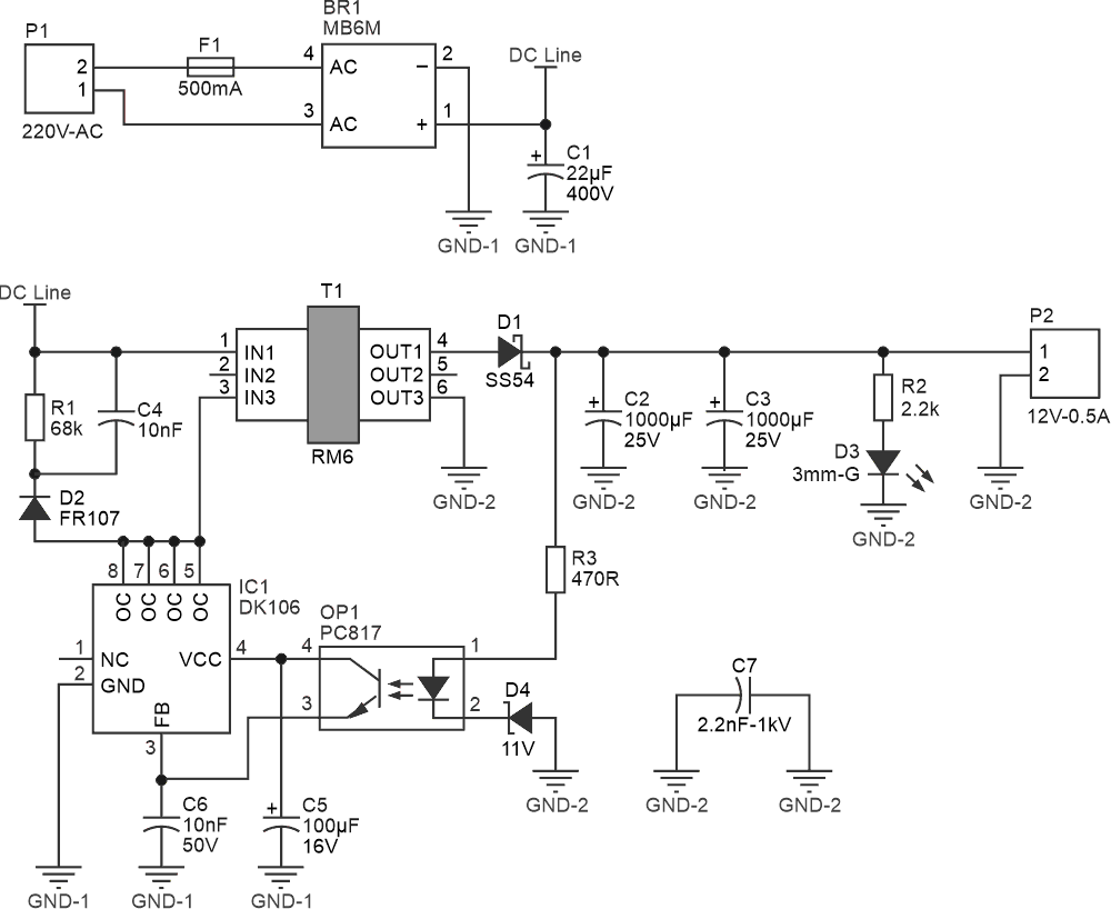

Figure 1 shows the schematic diagram of the device. The heart of the circuit is the controller chip, DK106, which makes it simple, cheap, and easy to build.
Schematic diagram of the 85 VAC-260 VAC to 12 V-0.5 A AC-to-DC Isolated Flyback Converter.
Figure 1. Schematic diagram of the 85 VAC-260 VAC to 12 V-0.5 A AC-to-DC Isolated Flyback Converter.
According to the datasheet, the features of the DK106 are as follows:
  • 85 V – 265 V wide-range AC power input.
  • Double chip design with bipolar junction transistor (BJT) to save cost.
  • Large-scale MOS digital circuit design with E class BJT driving, so that to enhance its high voltage resistance capability.
  • Self-power supply circuit design, no need for additional IC to supply electricity to reduce component and cost.
  • Internal integrated constant high voltage current driving circuit, no need for additional resistance.
  • Over-current, overloading, over-temperature, over-voltage, output short circuit, and photo-coupler failure protection.
  • Internal ramp compensation circuit to keep the stability of the circuit in low voltage and high-power conditions.
  • Internal PMW oscillation circuit with Frequency jittering control to keep EMC characteristics.
  • Internal frequency conversion. frequency-down in low load conditions complies with the European standard (standby power <0.3 W); also reduces the output voltage ripple.
  • Ramp current drive circuit included to reduce IC power loss and raise circuit efficiency.
  • 4 kV anti-static ESD test.
P1 is a KF127 terminal for the AC input. F1 is a 500 mA fuse. It is preferred to use a fusible resistor instead of F1 because it helps to reduce the input even further (an RC filter). BR is an MB6M bridge rectifier and C1 is a 22 µF-400 V electrolytic capacitor for ripple reduction. R1, C4, and D2 build an RCD snubber circuit to dampen HV switching spikes and ringing on the Drain pin of the controller’s internal MOSFET (OC pin). C5 and C6 are used for noise reduction.
OP1 is a PC817 optocoupler that provides a galvanically isolated circuit path for the controller to sense the output voltage and adjust the PWM pulse duty cycle at the transformer’s primary. D4 is an 11 V Zener diode to regulate the output voltage level and R3 limits the current to OP1. C2 and C3 are output capacitors for noise reduction and stabilization. D3 is a 3 mm LED, indicating a correct voltage level at the output.

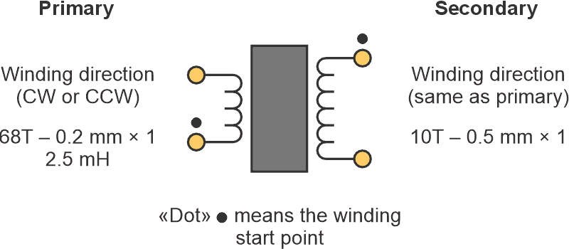

Transformer
Figure 5 shows the winding pattern of the transformer. The ferrite core is RM6.
Transformer and winding directions.
Figure 5. Transformer and winding directions.
Start the procedure by winding the primary, clockwise or counterclockwise. Then put the ferrite cores in place (in the bobbin) and measure the inductance of the primary winding using an LCR meter. If you can set the measurement frequency on your LCR meter, the best frequency is 65 kHz (switching frequency of the transformer), otherwise, set it to 40 kHz. Grind the middle leg of the ferrite core and measure the inductance of the primary winding till you measure a value as close as possible to 2.5 mH. A small tolerance is acceptable and does not cause a problem (for example 2.46 mH or 2.54 mH). Finally, wind the secondary and put the transformer in place.
