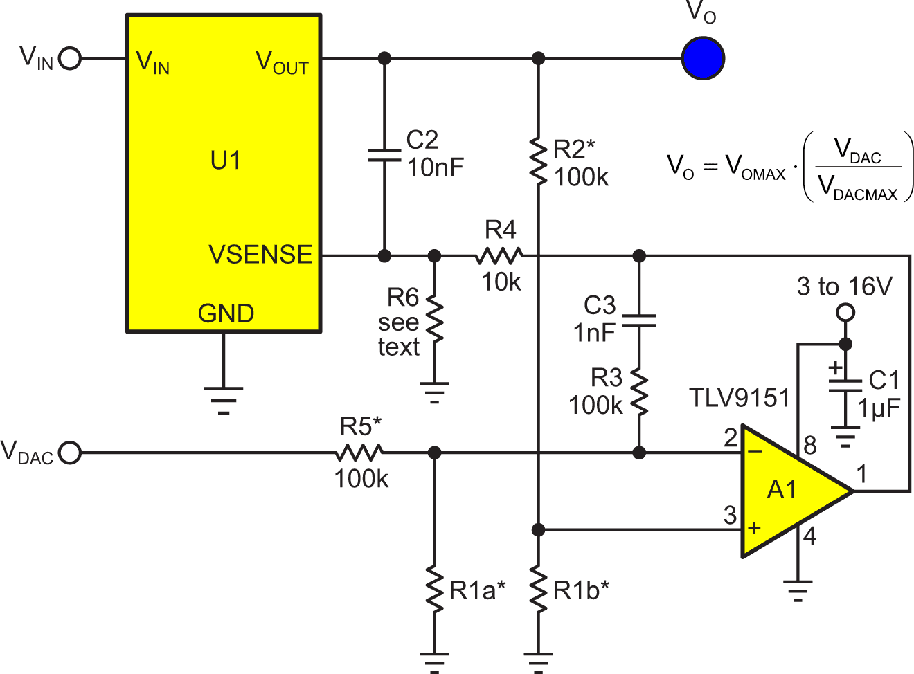

An old rule of thumb suggests that when one facet of a problem makes the solution complex, sometimes a simple (and better) solution can be found by just ignoring that facet. So, I decided, just for fun, to give it a try with the regulator reference problem. Figure 1 shows the result.
DAC control of a regulator while ignoring its internal voltage reference.
Figure 1. DAC control of a regulator while ignoring its internal voltage reference.
Figure 1’s simple theory of operation revolves around the A1 differential amplifier.
If VDACMAX >= VOMAX then
omit R1b.
If VOMAX >= VDACMAX then
omit R1a.
A1 subtracts (suitably attenuated versions) of the control input signal (VDAC) from U1’s output voltage (VO) and integrates the difference in the R3C3 feedback pair. The resulting negative feedback supplied to U1’s VSENSE pin is independent of the VSENSE voltage and is therefore independent of U1’s internal reference.
With the contribution of accuracy (and inaccuracy) from U1’s internal reference thus removed, the problem of integrating it into the design is therefore likewise removed.
Turns out the potential for really good precision is actually improved by ignoring the regulator reference, because they’re seldom better than 1% anyway.
With the Figure 1 circuit, accuracy is ultimately limited only by the DAC and very high precision DACs can be assembled at reasonable cost. For an example see, “A nice, simple, and reasonably accurate PWM-driven 16-bit DAC” (Ref. 1).
Another nice feature is that Figure 1 leaks no pesky bias current into the feedback network. This bias is typically scores of microamps and can prevent the output from getting any closer than tens of millivolts to a true zero when the output load is light. No such problem exists here, unless picoamps count (hint: they don’t).
And did I mention it’s simple?
Oh yeah. About R6, depending on the voltage supplied to A1’s pin 8 and the absmax rating of U1’s VSENSE pin, the possibility of an overvoltage might exist. If so, adjust the R4R6 ratio to prevent that. Otherwise, omit R6.
