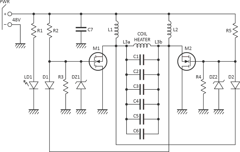

By observing the circuit diagram in Figure 1, we can see a symmetrical two-branch structure in the control circuit, known as a Royer oscillator, which enables self-oscillation of an RLC block at its natural resonance frequency.
Circuit diagram.
Figure 1. Circuit diagram.
The RLC block consists of an inductor (commonly called the “work coil”), a capacitor bank (called the “tank capacitor”), and the series resistance introduced by the components and wiring.
Once powered, the oscillator enters resonance. The high resonance current flowing in the work coil generates a strong magnetic field.
When the Royer oscillator is powered, even if symmetric, one of the two MOSFETs (M1 or M2) will start conducting first due to manufacturing differences. Assume M1 starts first – its drain is pulled to ground potential, forcing M2 off via the feedback diode D1, which quickly discharges the gate of M2.
The resonant circuit composed of inductor L3 and capacitors C1 through C6 presents a sinusoidal half-wave at M2’s drain, going from zero to peak and back to zero. As it returns to zero, D2 conducts, turning M1 off and switching M2 on, generating the opposite sinusoidal half-wave.
This cycle repeats at the natural resonance frequency of the RLC block. The L3 work coil carries a high sinusoidal current around 100 kHz. While this frequency produces mild heating in food, it already generates significant heating in a steel bolt, increasing with available power and induced electromagnetic field.
The MOSFETs operate in push-pull: when M1 is on, M2 is off and vice versa. This is ensured by the resonant circuit and feedback diodes D1 and D2. Simultaneous conduction would short-circuit the supply, destroying the MOSFETs.
MOSFET switching occurs with nearly zero VDS (drain-source voltage), i.e., Zero Voltage Switching (ZVS), minimizing switching losses:
PD = VDS × ID,
where ID is the drain current.
ZVS also significantly reduces the high-frequency noise naturally emitted by switching circuits.
MOSFETs M1 and M2 are Infineon IRFP260N, featuring a very low RDSON (only 40 mΩ) and high drain current (ID = 50 A). They are Fast Switching types, switching quickly from full conduction (on) to cutoff, including their antiparallel protection diodes with a TRR (Reverse Recovery Time) around 400 ns.
The peak voltage (VPK) in a ZVS switching circuit is calculated as:
VPK = VSUP × π,
where VSUP is the supply voltage.
Since the supply voltage is limited to 48 V DC, the maximum drain-source voltage (VDSS) is selected as 200 V.
The feedback diodes D1 and D2 are MUR420, also fast switching, capable of carrying at least 4 A and quickly turning off the associated MOSFET by discharging the gate.
The GATEs of the two MOSFETs are driven by power resistors R2 and R5, each valued at 470 ohms.
To protect the MOSFETs from overvoltage and overcurrent, two Zener-resistor pairs are used: R3/DZ1 and R4/DZ2. R3 and R4 are 10 kohms; DZ1 and DZ2 are 12 V – 1 W.
LED LD1 indicates the presence of power and is powered through the series resistor R1, 4.7 kohms, to limit current.
Inductors L1 and L2 are 100 µH and serve to suppress switching voltage spikes (“spikes”) that could destroy the MOSFETs. They are wound on toroidal cores with a maximum current rating of 13 A.
Capacitors C1, C2, C3, C4, C5, C6 are MKP polypropylene capacitors, chosen for their ability to withstand high currents and voltages during resonance while minimizing losses.
In this design, the resonance capacitance is approximately 2 µF, achieved by paralleling six 0.33 µF capacitors rated at 630 V.

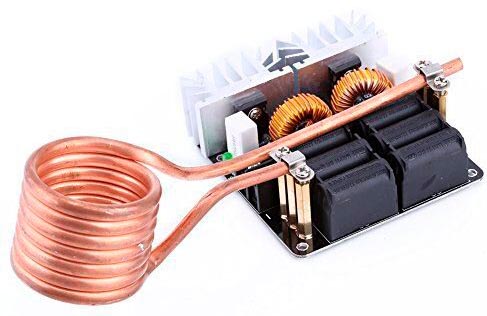

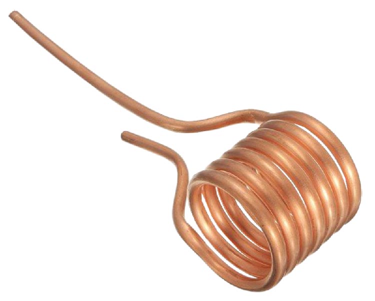

The work coil (Figure 2), into which the object to be heated/melted is placed, is made of 6 turns of 6 mm diameter hollow copper tube with 0.8 mm wall thickness. It is air-wound to handle high currents, dissipate generated heat effectively, and reduce skin effect losses at 100 kHz.
The coil consists of spaced turns of copper tubing.
Figure 2. The coil consists of spaced turns of copper tubing.
The turns must not touch each other (since the copper is bare), otherwise short circuits will form, reducing the number of effective turns and altering inductance. The theoretical inductance of the work coil is about 1.26 µH, though this may vary depending on the length of the horizontal leads connected to the capacitors. To calculate the theoretical self-inductance, you can use the formula (refer to Fig. 3):

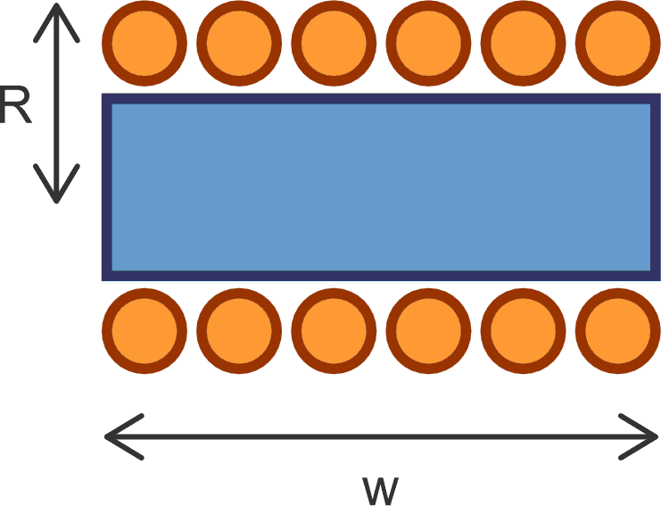

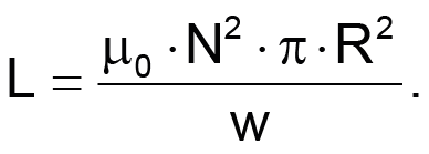

Where
µ0 is the permeability of free space (µ0 = 4π×10–7 H/m),
N is the number of turns (in our case, 6),
R = 2.5×10–2 m,
w = 7×10–2 m.
Hence L ≈ 1.26 µH.
The coil has a radius R of 2.5 cm and length w of 7 cm.
Figure 3. The coil has a radius R of 2.5 cm and length w of 7 cm.

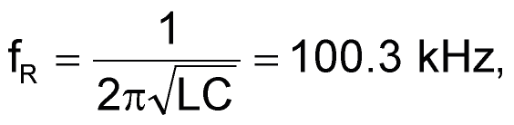

To calculate the theoretical resonance frequency, use the formula:
where L = 1.26 µH, C = 2 µF.

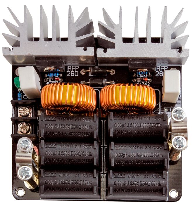

The assembled board is shown in Figure 4. The component list is shown in Table 1.

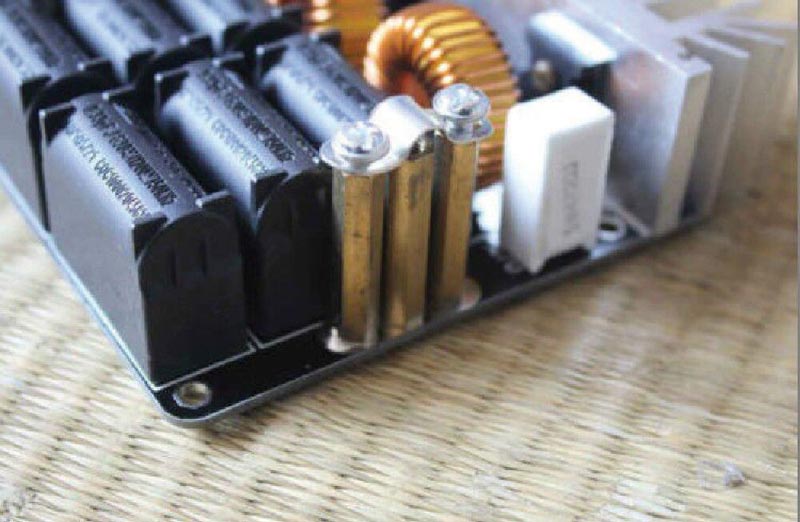

Coil fixing standoffs.
Figure 5. Coil fixing standoffs.
To mount the coil, three 6 mm golden hexagonal standoffs, each 40 mm long, are used. The two lateral ones are fastened (using 4MA screws) with an iron clamp that secures the ends of the work coil. Loosen the screws holding the two standoffs (Fig. 5), insert the ends of the work coil into the metal support so that the coil is oriented toward the power supply terminal block marked “+/–“. Position the work coil so that less than 1 cm of tubing extends from the standoff support, and tighten the screws (Fig. 6).

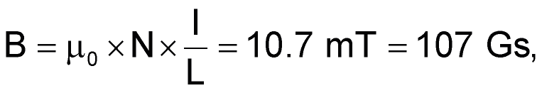

The current circulating through the work coil has an RMS value of approximately 100 A. With such a high current, the magnetic field is significant, and all nearby objects are exposed to its field lines – hence, sensitive electronic devices might experience interference. The magnetic flux density B can be calculated with the formula:
where N = 6, I = 100 A, and L = 1.26 µH.

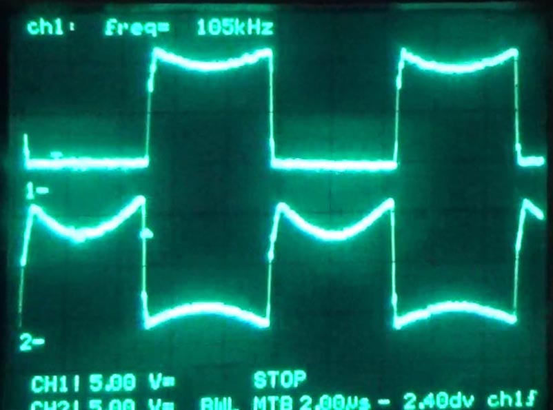

Fig. 7 shows the oscilloscope waveforms of the gate-source voltages of M1 and M2. As can be seen, they are perfectly in antiphase. Before the GATE voltage of M2 reaches the high level and M2 turns fully on, M1’s GATE voltage is already low, ensuring M1 is off and preventing simultaneous conduction, which would destroy the MOSFETs.

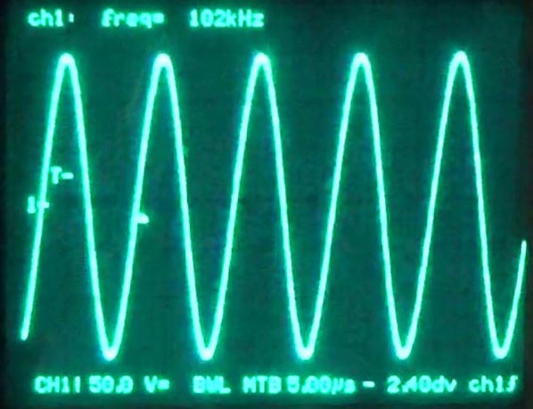

Fig. 8 shows the voltage applied to the work coil, reaching around 150 V peak and maintaining a perfectly sinusoidal waveform, thanks to the parallel RLC resonant circuit.

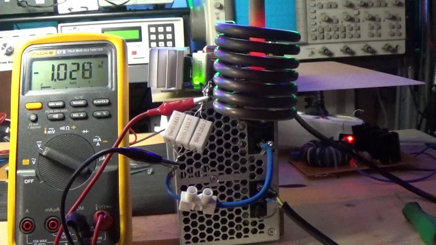

Finally, Fig. 9 shows the current drawn by the circuit at an input voltage of 48 VDC, which is approximately 17 A.
Shunt to measure current drawn by the circuit.
Figure 9. Shunt to measure current drawn by the circuit.
The measurement was made by detecting the voltage drop across a 0.06 ohm shunt resistor (obtained by paralleling three 0.18 ohm resistors) using a digital multimeter, with a metal object inserted in the work coil.

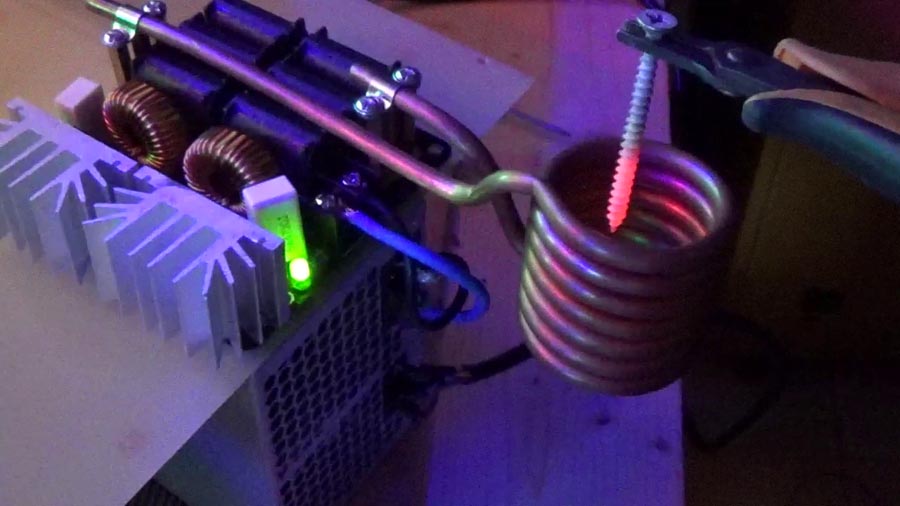

At this point, the resonance current starts flowing through the work coil at approximately 100 kHz. If powered at the full 48 VDC without any metal object inside the work coil, power consumption remains under 500 W; however, when a conductor is inserted, depending on its material, size, shape, and position, power consumption can vary greatly up to 1,500 W.
Choose the conductor to be inserted – like a metal screw – hold it with pliers (do not get too close to the coil) to avoid burns.
Insert the conductor slowly into the work coil, ensuring it doesn’t touch the inner coil walls. Keep the conductor vertical inside the work coil.
The inserted conductor acts as the transformer’s secondary, with the work coil being the primary winding. Being inside a solenoid, the conductor is exposed to a strong magnetic field. Within seconds, due to the Joule effect, the conductor heats up and glows with typical incandescent orange-yellow tones (Fig. 10).
Position the object inside the coil.
Figure 10. Position the object inside the coil.
This condition can be maintained for tens of seconds. However, be extremely careful as temperatures rise rapidly – do not touch the conductor, coil, or heatsinks directly to avoid burns. After several minutes of use, the work coil will begin to darken, eventually turning nearly black from the heat generated. This will not affect its performance.
