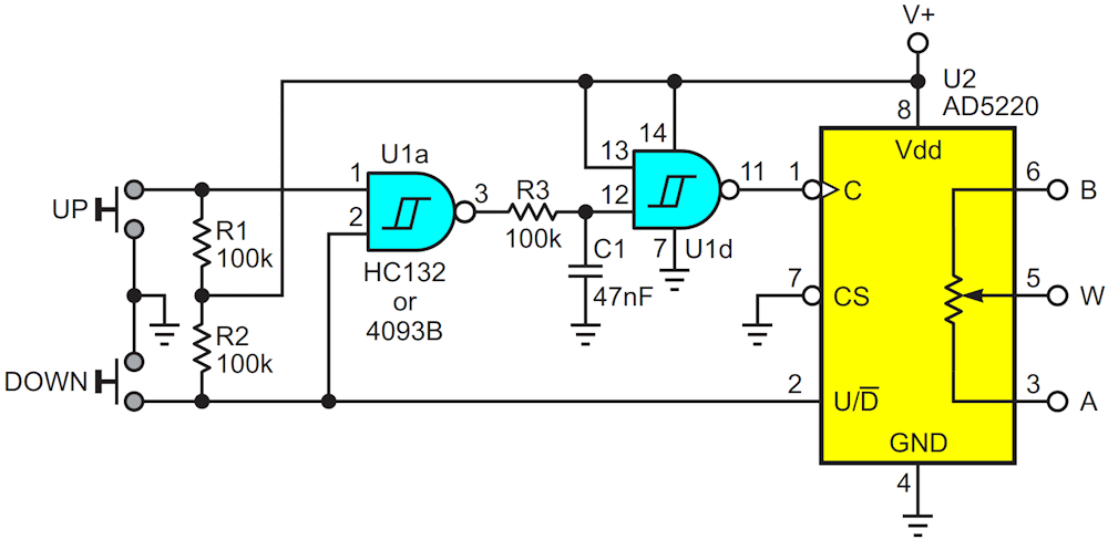

In contrast to Jayapal Ramalingam’s design, Figure 1’s circuit implements my preferred method. It bumps DPOT U2’s setting by one count each time the UP button is pressed, and un-bumps it when DOWN is mashed.
This pushbutton-to-digital-potentiometer interface is optimal for impatient people.
Figure 1. This pushbutton-to-digital-potentiometer interface is optimal for impatient people.
Here’s how it works.
Pushing either button makes U1a’s pin 3 go high. Contact bounce is filtered out by R3C1’s ~5 ms time constant, and Schmidt trigger inverter U1d then delivers a single clean low-going transition to U2’s clock input. This makes U2’s wiper take one step up if its pin 2 is high (i.e., the UP button is pressed and DOWN isn’t) or one step down if pin 2 is low (i.e., DOWN is down).
Other than that difference, there’s really no compelling reason to choose Figure 1 over RJ’s circuit. Figure 1’s parts count does include one fewer chip, but so what? They’re cheap.
